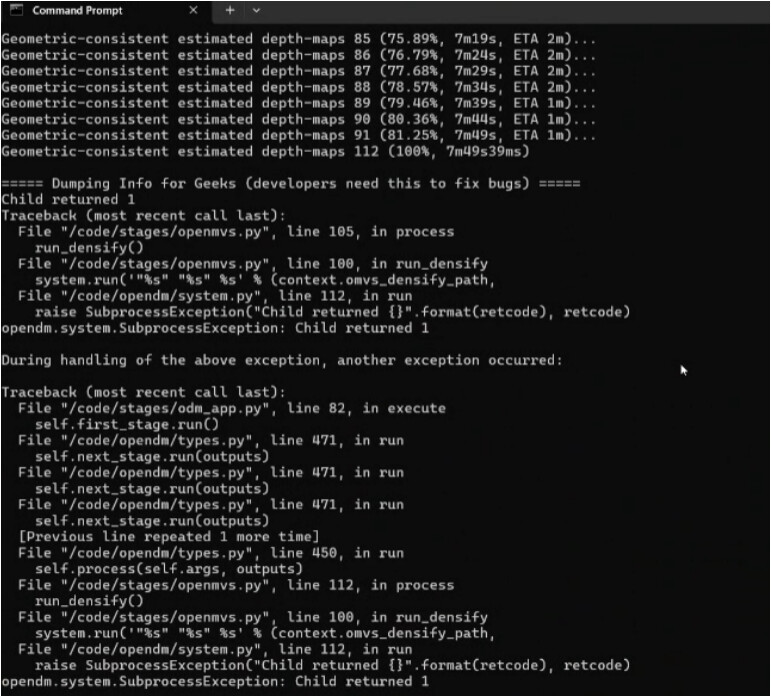

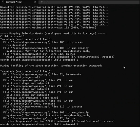

Here is the snapshot of error:
You’re running out of memory. Can you add more RAM and/or swap?
Try all defaults except dspsift and background removal.
