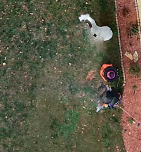

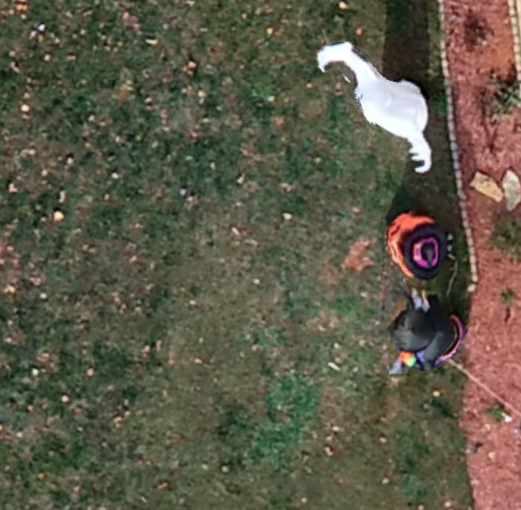

I’m sold, tried it out compared to sift and it processed a small dataset in 12 minutes less time. resolution is about the same. below is screenshots from from dsp sift and sift of my kids halloween decorations.
dsp sift
and sift
Ha! Great orthophoto topic.
