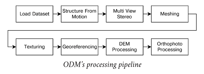

Sequential order of processing stages
Do the task configuration info pop-up tips in the WebODM GUI correctly list the processing stage order?
E.g. the tooltips for “rerun-from” and “end-with” suggest this is the sequence, but it seems to me that the merge stage would actually happen somewhere near the end:

Source: Toffanin, P. (2019). OpenDroneMap: The Missing Guide (1st ed.).
This predates a few changes, but it should be mostly representative still.
If I understand correctly, the flow should be like this (and agrees with the tooltip):

The progress values here seem to confirm this flow:
I could have it wrong, however :grimacing:
