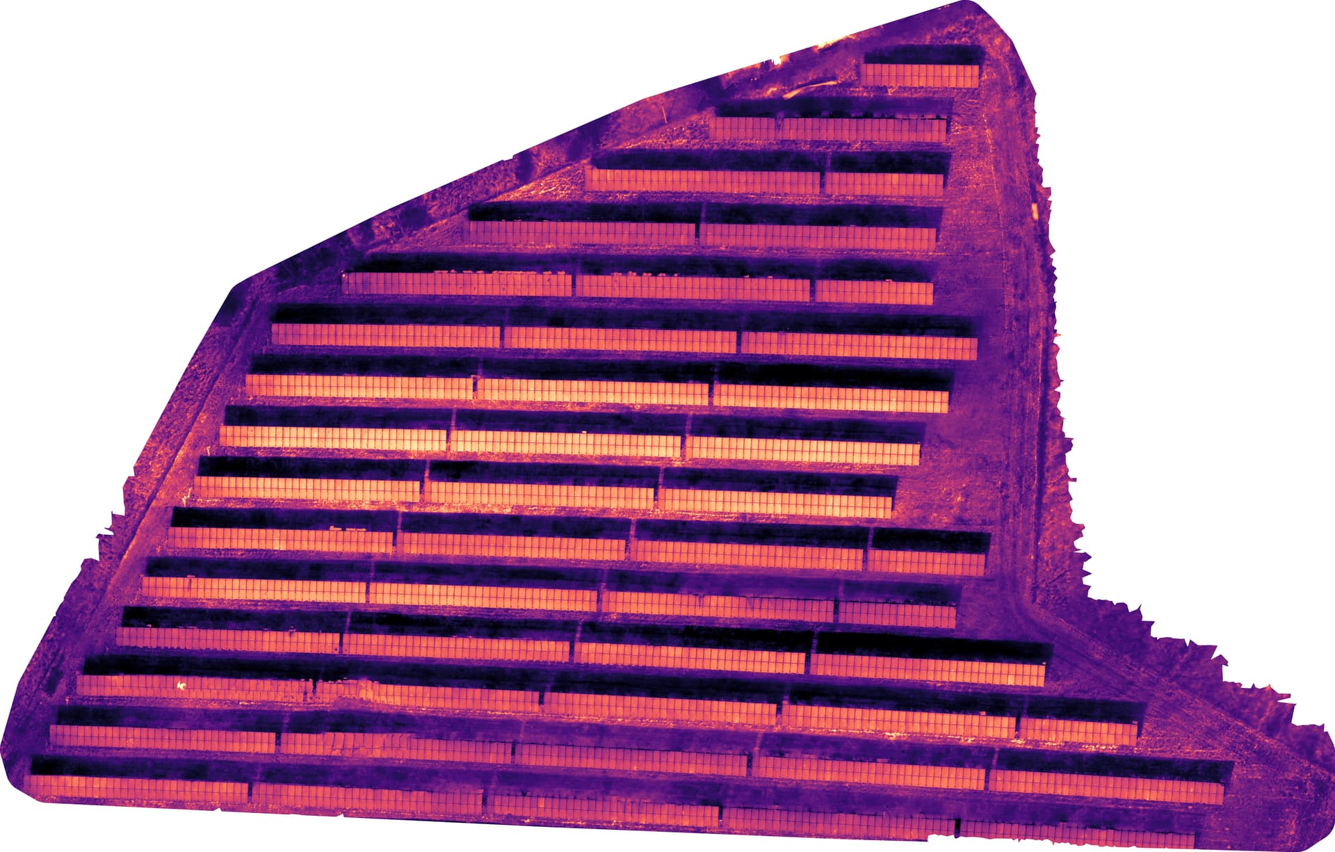

For that I’ve been orienting myself on flight guides of commercial software. An example of such a flight guide is: DJI Mavic 3 Thermal (M3T) Flight Guidelines - Raptor Maps They are specifying a 70% side overlap and a 20% front overlap, I’ve been playing it safe with 80%/80%. Biggest issue so far are random artifacts in the thermal orthophotos.
My best results of that:
But as you can see, still lots of artifacts, sadly. Also the brightness of the middle rows seems to be a sky reflection. The parameters for the image calculation in WebODM are:
auto-boundary: true, camera-lens: fisheye_opencv, feature-type: sift, gps-accuracy: 2.8, min-num-features: 100000, optimize-disk-space: true, orthophoto-resolution: 1, radiometric-calibration: camera, use-fixed-camera-params: true

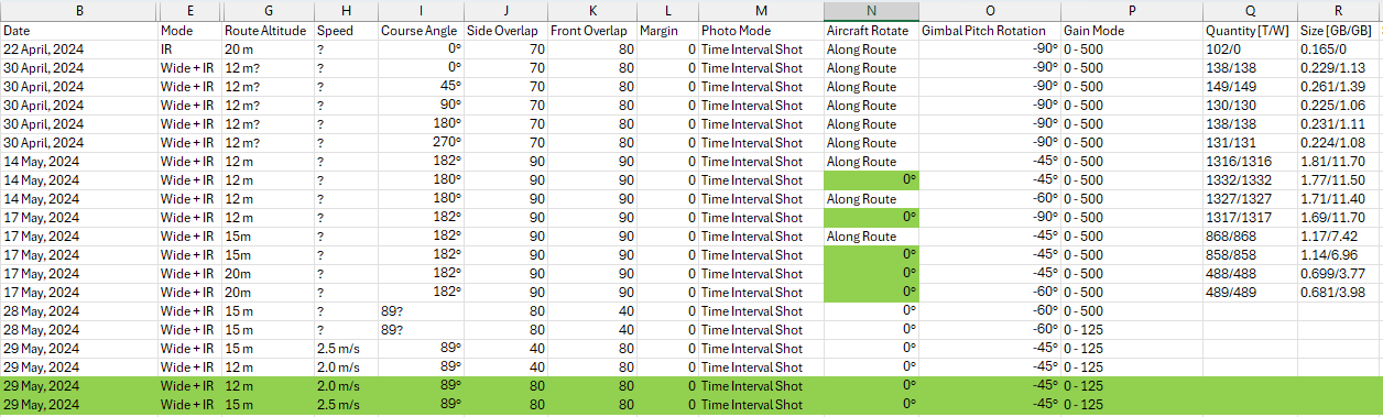

Related to the image taking process, see the Excel table below with the flights done at the time of writing this. The whether have not been great for the past week, so I’m planning to perform other flights at the end of next week. Any recommendations?

The result is actually a plain gray image. If you are on WebODM when switching to “Plant Health” you will be able to see the thermal orthomosaic. If everything works well, you should see on Layers the Algorithm “Celsius” and the Color applied to it. Normally, Magma.
