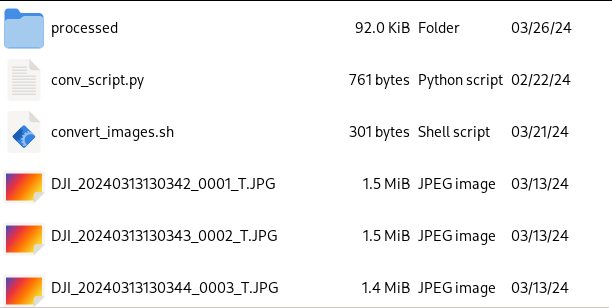

The file structure in the folder in which the script is run should look like this (thermal.py is at the bottom of the folder):
grafik
The solution is not exactly pretty but works for me at least. :slight_smile:
