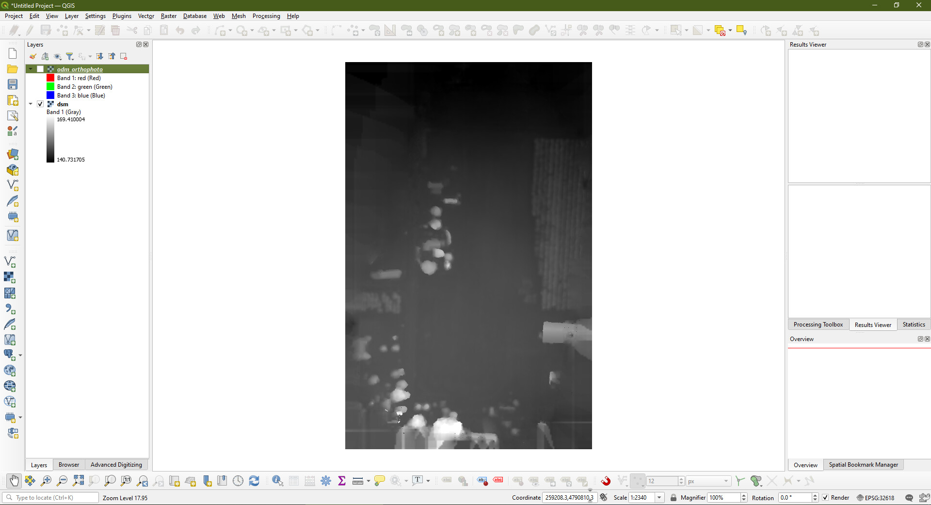

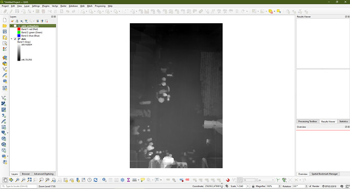

With ODM run in Docker that’s what I always get when I export a dtm. Perfectly visible in ODM, but exported TIF files have the area of interest all white, surrounded by black. No amount of adjusting the histogram in GIMP reveals any details.
Jeff and Gordon, I do normally export dsm.

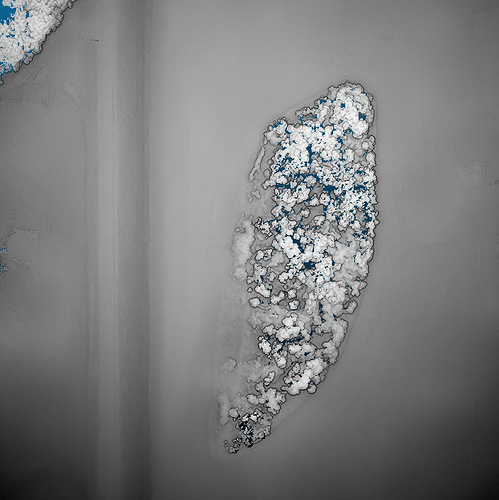

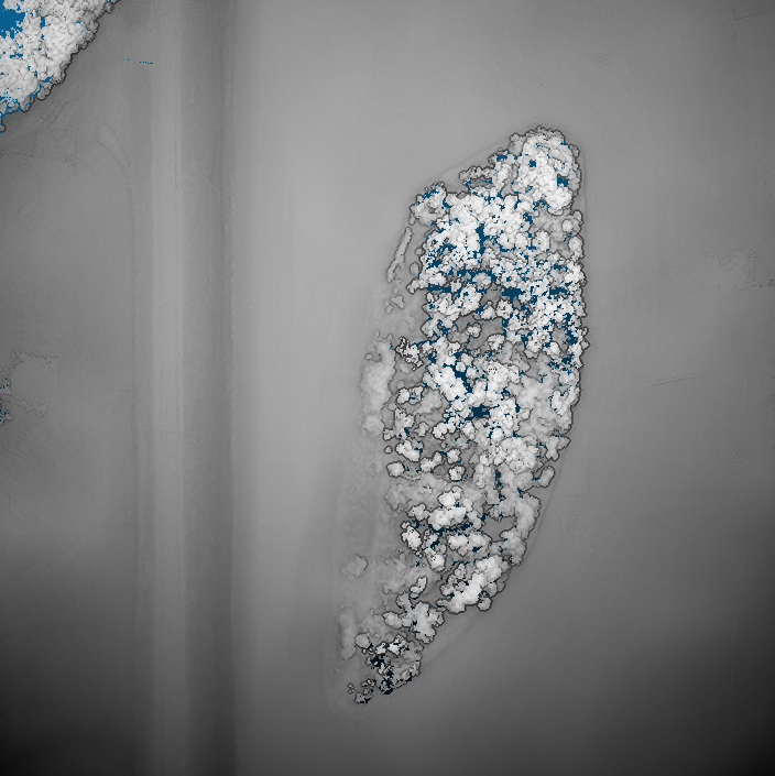

Looks like the test projects I’ve processed all have properly generated DSMs
What dataset/parameters were you having trouble with?
I am not feeding any parameters for the processing of the dtm. Just default values.
Should I be? Here is the command I have been using to generate the DTM and other products.
run “D:/Projects/2Jansen Lake Field Island” --camera-lens brown --dem-decimation 1 --dtm --feature-quality ultra --mesh-octree-depth 8 --pc-filter 0 --pc-las --pc-tile --rerun-all
The point cloud is fine when viewed in Cloudcompare.
