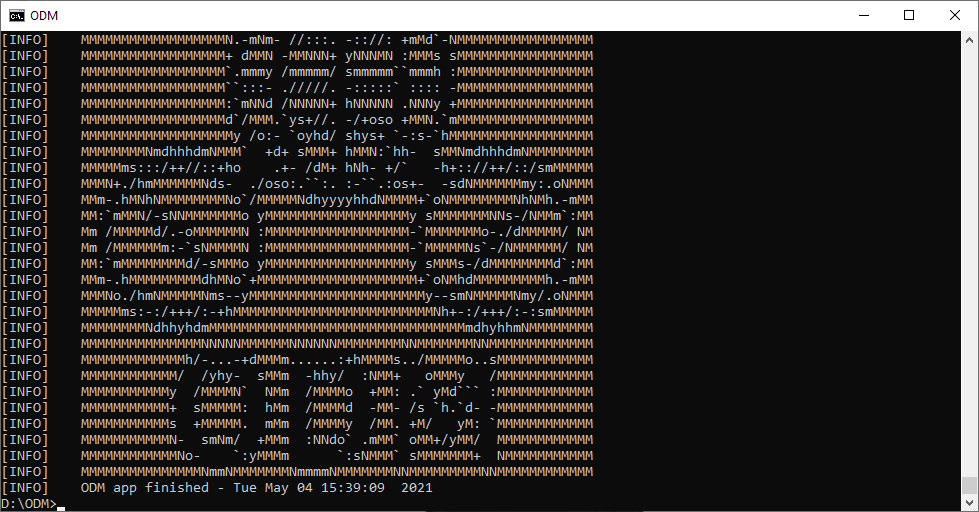

At 15:45:29pm EST on 4/30/2021 ODM ran the first pipeline stage (dataset) successfully.
To quote another Italian named Cristiano when I informed him of this effort: “Grande Piero.”
First native pipeline run completed from end-to-end. :tada:
