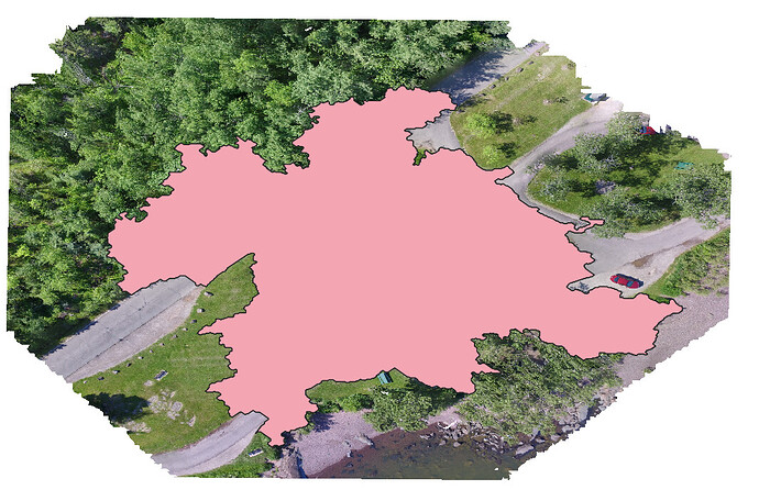

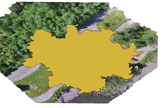

Vertical cutlines computation working.

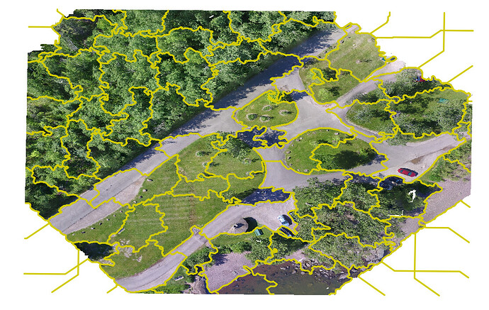

Now repeat for horizontal, create linestrings, simplify, polygonize, union all, select largest.
Vectorized linestrings
End result:
Compared to previous GRASS computation:

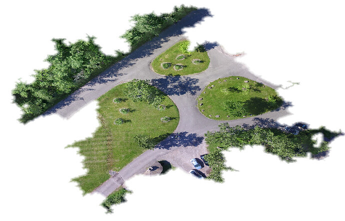

Feathered raster:
