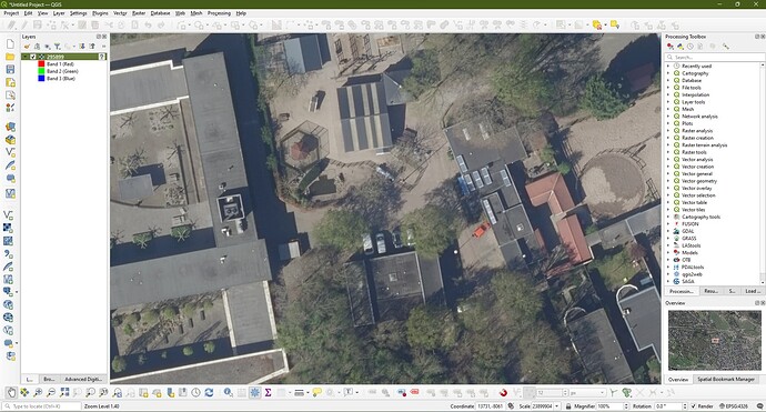

Dang… 450MP image! I’m surprised it worked at all!
Extent
1:1
Is it possible for you to downsize it a bit? Looks like 180MP is PIL’s cap at the moment for whatever reason.
