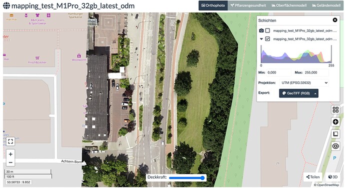

The Orthophoto looks great!

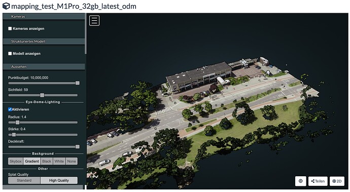

The point cloud as well.

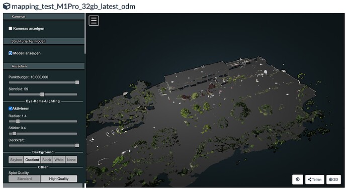

But the structured model is a mess.
I know that dataset isn meant for 3D models, due to only vertical and no oblique images. In the past, i was able to generate some 3D models with only vertical images but on an amd 5950x mit a bit more ram.
is it only a problem with the M1Pro?
i appreciate any help.

I think we somehow broke PoTree with that dataset! Look how the “textured” areas are largely null, showing the PoTree default empty background color, and still showing the sidebar texture when moved over where it used to be displayed.

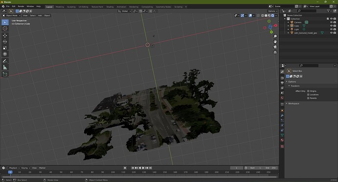

Looks like Blender 2.93 LTS can handle it, however:

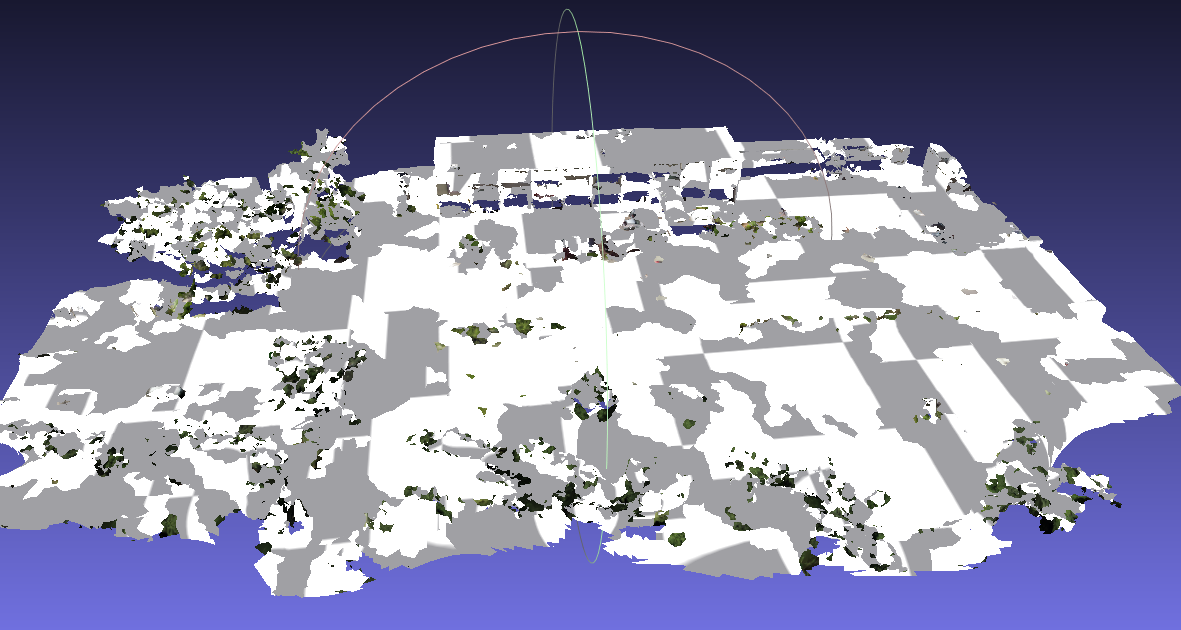

This looks exactly like what I have in meshlab. The problem is the first texture image is too large to be loaded, and it contains most of the textures. But the other textures images are relatively small, so they can still be seen in the 3D model.
