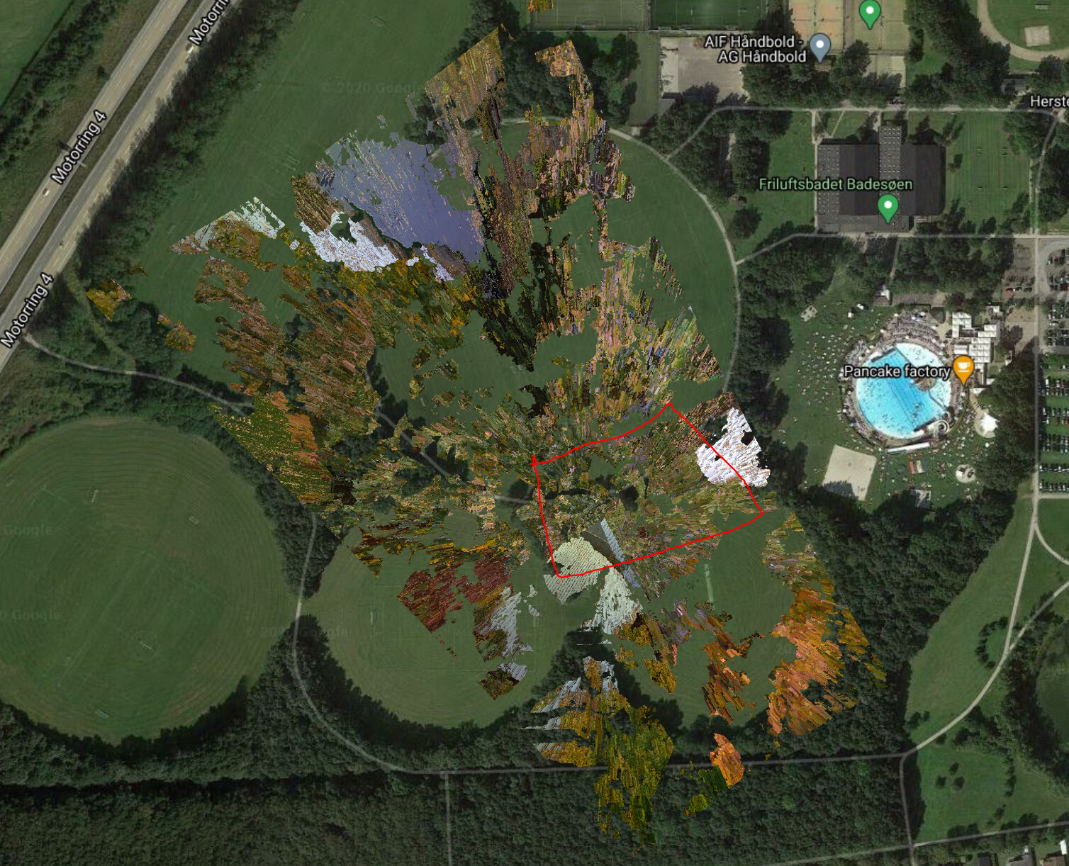

First attempt at a high-resolution processing job did not go quite as planned.
I selected 5 out of about 140 images - all sequentially and overlapping about 80% along the flight path.
The red box marked is the total survey area - the processed images are a small rectangle a over the buildings visible along the treeline in the middle left of the Google Maps image.
The processing result has spread the data randomly (or so it appears) over a much larger area.
I did a new job, selected Fast Orthophoto - and result was much better as seen on the third image - but scaling is off with the generated image larger than the reference Google Map - and I see entirely missing patches in this image.
HiRes
(Had to delete two images, as I can only attach one…_

You might need more images, maybe around 15 or so, and not only sequential. Think more like a box or so of coverage (so might be images from multiple flight lines, instead of just sequentially one by one).
Shouldn’t matter if they are coming out of camera that way… I’ve processed 16:9 4K video using Pix4D before, so I know that it is certainly possible in general.
I’ve yet to specifically try 16:9 in ODM, but I suppose I could try something.
Thanks, will load all 143 images an let it run overnight :slight_smile:

Moved to my MacBook Pro, gave WebODM 48 GB of memory - and I now have both a 3D and a 2D model. Need to study the parameters in the 3D browser a bit, but looks promising.
Doing another one this evening with 4x3 images shot at 4K - the Evo 2 camera is really only 12 Mpixel anyway.
