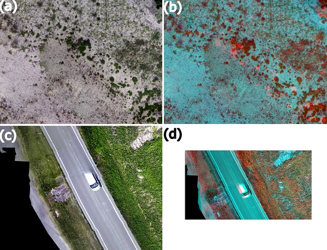

  • The RGB image is fine, but the MS (RE, NIR) image appears off. I believe this is due to the misalignment between the camera sensors of Maivc 3M. Is there any way to correct this misalignment, either through options or post-processing?
(a) This image is a RGB true coler image. this has no problem
(b) This image shows the NIR set to red. If you look at the shrub in the middle, only the red color appears to be shifted to the left.
(c) Another location in the same orthophoto. A car is in the picture.
(d) As in the image above, this is an image with NIR set to red. Cars and lanes are shifting to the left about the red color.

The misalignment has already occurred in the original image. Comparison with the original image shows that the image is misaligned due to differences in the bands in the same image.
I believe this is due to the physical misalignment between the sensors.
This image shows the NIR, R, and G bands merged as an RGB image for one original image (before the orthophoto was created). You can see that there is already a shift between the bands.

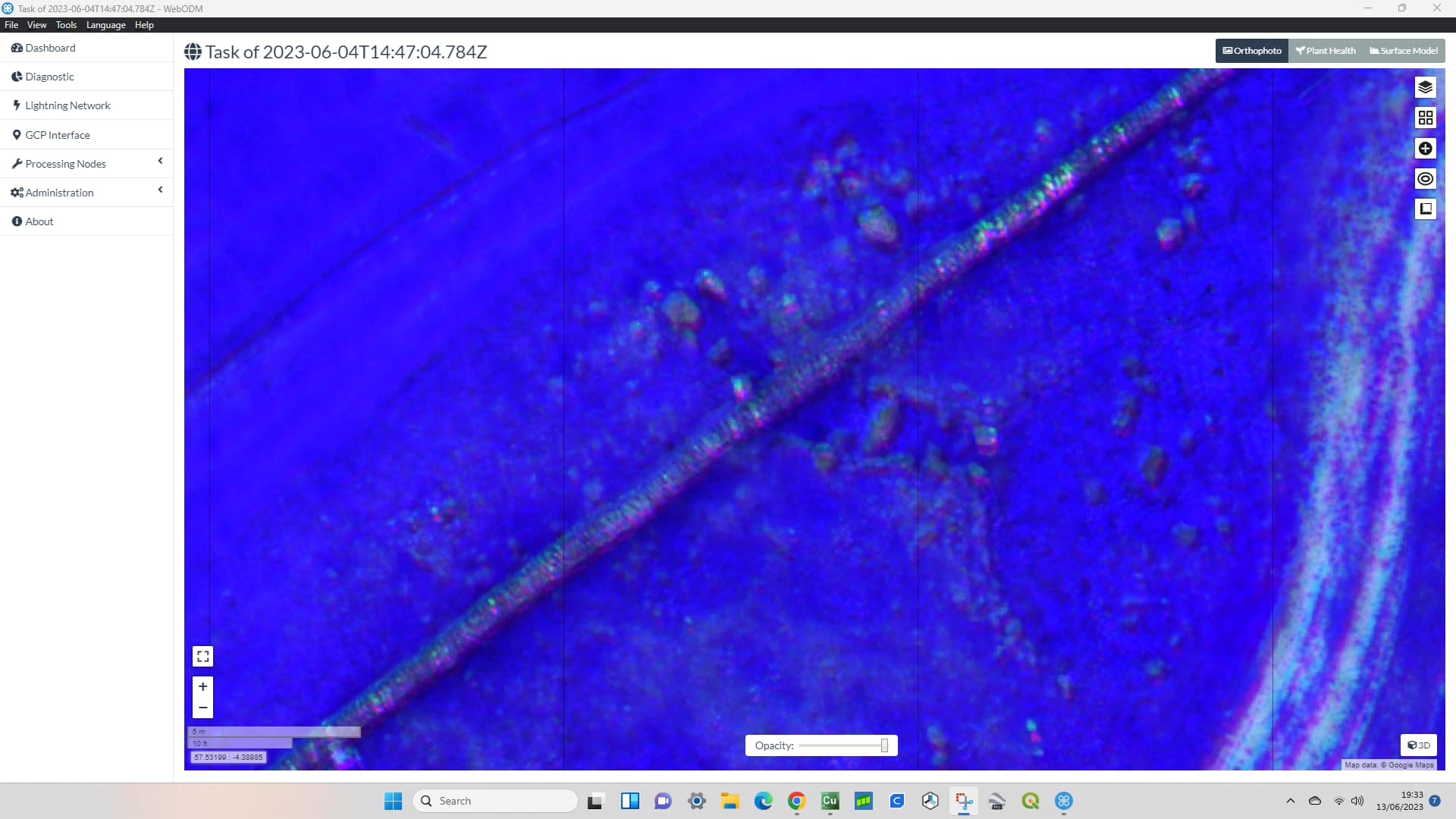

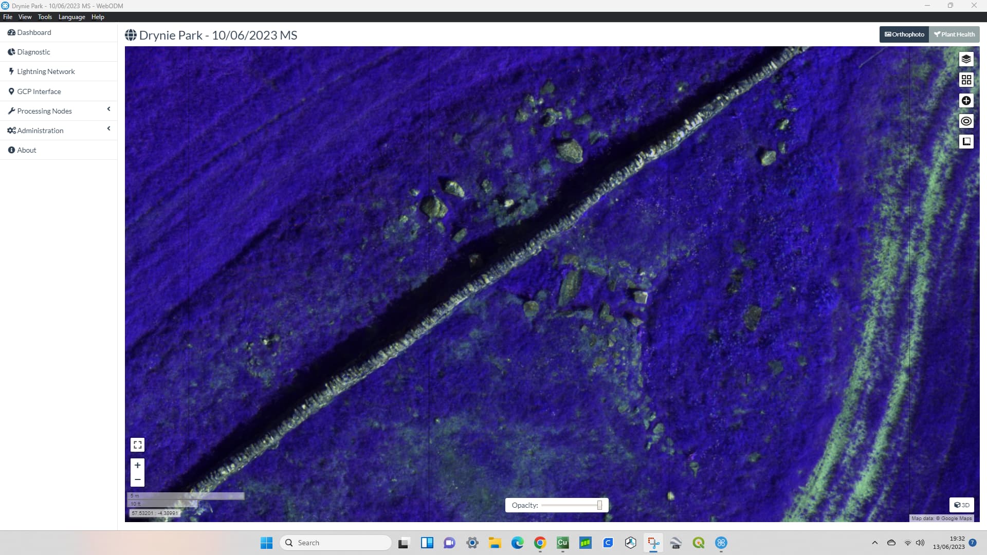

Interestingly, I have had an issue with “ghosting” in the MS data sets I have acquired myself from the M3M, and also using a colleagues data set, also from the M3M. One thing I have noticed - but I am uncertain as to whether this is the cause - is that the ghosting seems to appear worse the greater the mission altitude. I have not performed any tests on this, so this is anecdotal, but may provide a clue as to how to correct for it.
These were flown on different days, from 30m and 85m AGL, but show the differences I obtained.
