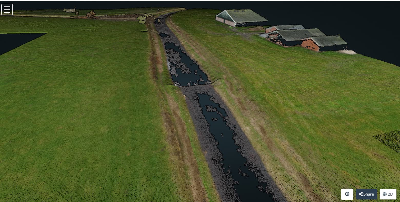

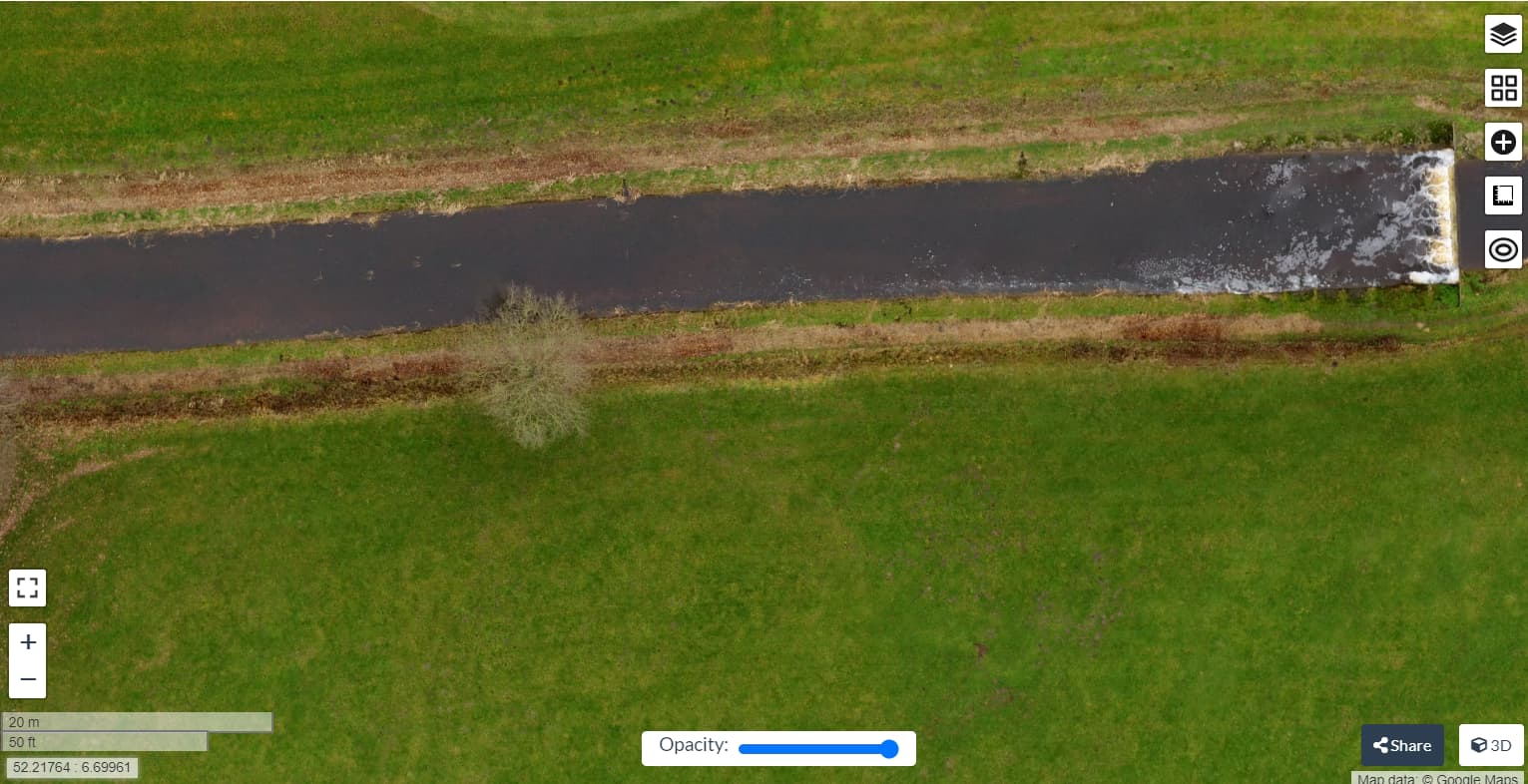

My experience is that (flowing) water is always a challenge to map. Also with the other (commercial) mappingproducts. Especially if it’s only (flowing) water visible on the pictures. I dont know wide the stream/river is but my advise is to always have “some” shore in your images.
I just remembered I had a small “river” example. As you can see the 2D map looks (pretty) good. But in the 3D view you see the noise in the pointcloud. And since the 2D map is being generated based on the pointcloud (please correct me if Im wrong) I guess you can find anomalies in “water-mapping”.
2D
3D
