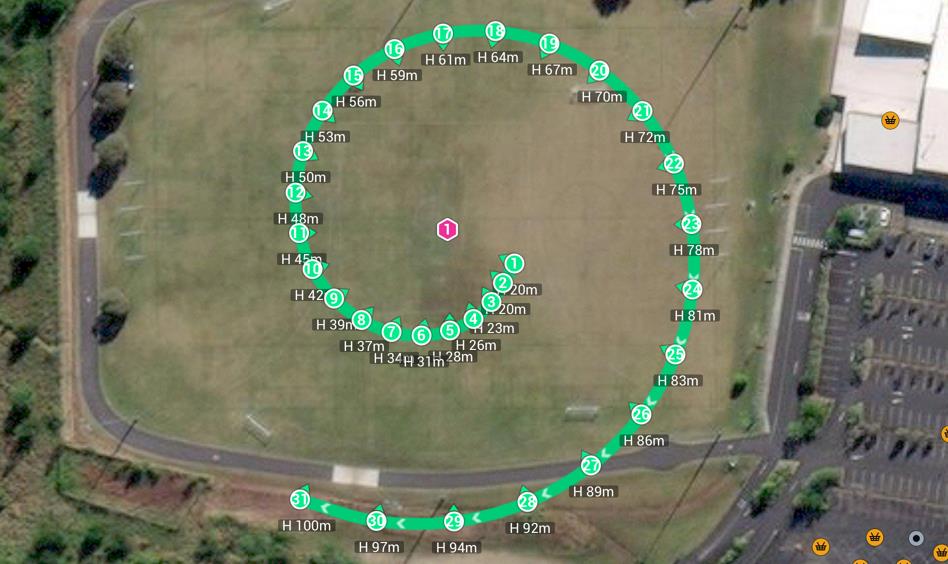

might this be of help
That sounds pretty cool. I will have to look into that! Thanks!
The link to the conversion is at Litchi Waypoint Mission to DJI Fly Waypoint Mission. It is worth reading the limitations, but I think it can work. As all I have ever worked with is non-enterprise DJI drones (M3 and Air 2S), I do not have any experience with Litchi. I will have to familiarize myself with Litchi first.
Thanks again for this idea.
Since you have an Air 2S working with Litchi, this is definitely worth my looking into. I have DJI RC Pro for my Air 2S, I will have to look at using Litchi directly with that. Do you happen to know if it works, or if I have to use an RC that works with a phone?
