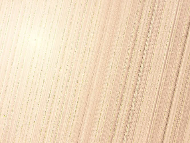

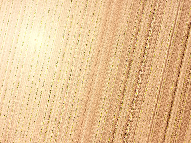

The images were pretty washed out, low sharpness, and had very low scene detail.
So, I pre-processed them lightly in XNConvert with an Enhance Detail and Auto-Contrast filter.
Original Image:
Pre-Processed Image:
The difference is subtle, but it is enough to really help during the matching phase.

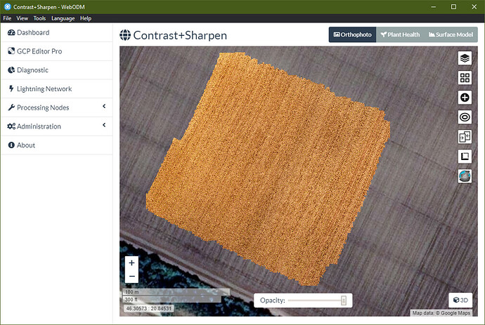

Processing using pretty much default settings worked great:
Options: crop: 0, debug: true, dsm: true, verbose: true
Orthophoto:

The Point Cloud is where we see some of the limitations of this dataset, this pre-processing workflow, and my settings come together.
The strong “waffling” is just a consistent lack of tiepoints extracted during matching. Maybe we could do significantly better by forcing the min-num-features up, or by cranking up pc-quality, feature-quality, and turning off resizing.

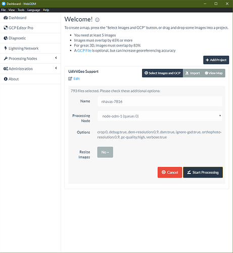

Thank you for your post, I truly appreciate you put this issue on your agenda. We have had success generating the orthomosaic with the default settings problems start to occure when we go high-res and define the resolution. It would be useful to see if these enhancements help with the following settings:
dem-resolution: 0.9, dsm: true, ignore-gsd: true, orthophoto-resolution: 0.9, pc-quality: high
When we try using them we run into a an error: empty initial point-cloud followed by a opendm.system.SubprocessException: Child returned 1

I can try again with Lightning with the same pre-processing I did before and the settings you included above. I’ll update you in time when it finishes.
