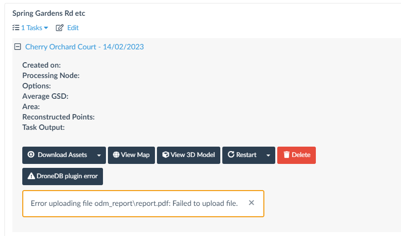

Thanks got it now it now, however I’m getting the failed upload message as per screenshot, WebODM is up to date (1.9.16)
We might need to push out another WebODM update to capture the fix for this module.
Can you use the browser or DroneDB Desktop in the interim?
Yep no problem
Sorry for the trouble!
