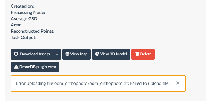

Failure On "Share to DroneDB" in WeboDM

Tried this with 2.0.1 on 2 machines and getting a failure on both
Can confirm/reproduce on the Windows build (though not so on the Docker/Linux build).

I downloaded the latest version of WebODM (ver 2.0.1). Still erroring out. Same error.

10 Days have passed and no update. Do you want Log files to see what can be reproduced?
Sure, logs are always helpful and will supplement what I sent them, so thank you.
app.log:

“python: [2023-05-15 14:21:04,543: INFO/MainProcess] Received task: coreplugins.dronedb.api_views.share_to_ddb[5ea1618d-853e-4cd0-8fe3-467dcde77e8a] \r\n”
“python: INFO Logged in to DroneDB as user snyderld.\r\n”
“python: [2023-05-15 14:21:05,650: INFO/MainProcess] coreplugins.dronedb.api_views.share_to_ddb[5ea1618d-853e-4cd0-8fe3-467dcde77e8a]: Logged in to DroneDB as user snyderld.\r\n”
“python: INFO Error uploading file odm_report\report.pdf: Failed to upload file… Retrying…\r\n[2023-05-15 14:21:13,326: INFO/MainProcess] coreplugins.dronedb.api_views.share_to_ddb[5ea1618d-853e-4cd0-8fe3-467dcde77e8a]: Error uploading file odm_report\report.pdf: Failed to upload file… Retrying…\r\n”
“python: INFO Error uploading file odm_report\report.pdf: Failed to upload file… Retrying…\r\n[2023-05-15 14:21:20,283: INFO/MainProcess] coreplugins.dronedb.api_views.share_to_ddb[5ea1618d-853e-4cd0-8fe3-467dcde77e8a]: Error uploading file odm_report\report.pdf: Failed to upload file… Retrying…\r\n”
“python: ERROR Error uploading file odm_report\report.pdf: Failed to upload file.\r\n[2023-05-15 14:21:27,254: ERROR/MainProcess] coreplugins.dronedb.api_views.share_to_ddb[5ea1618d-853e-4cd0-8fe3-467dcde77e8a]: Error uploading file odm_report\report.pdf: Failed to upload file.\r\n”
“python: [2023-05-15 14:21:27,268: INFO/MainProcess] Task coreplugins.dronedb.api_views.share_to_ddb[5ea1618d-853e-4cd0-8fe3-467dcde77e8a] succeeded in 22.71799999999348s: None\r\n”

I downloaded version 2.0.1 build 88 and still has the same error on mi side.
Correct, the fix has not been implemented into the latest releases yet.
We are working on it, though.
Is there a guide on how and what to manually upload the data?
