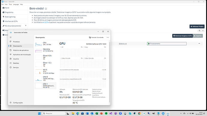

Regarding the GPU, I now captured it during the process and I realize that it is used, I think it is underused because when I use Pix4dFields it hits 100% for processing and I can process more than 150 photos.

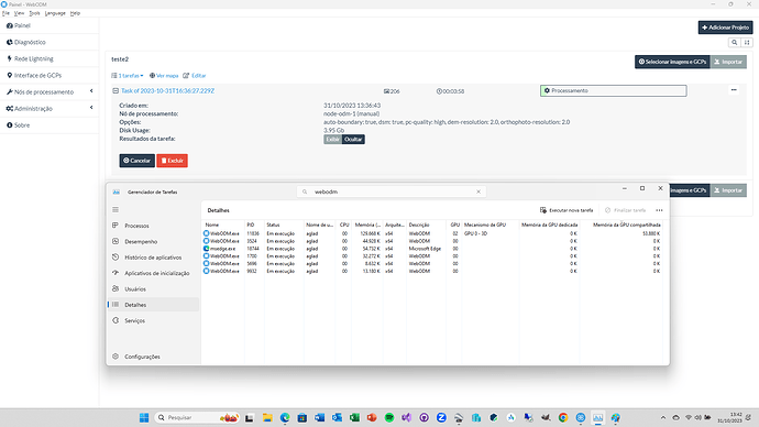

I’m processing the images at 50% resolution, they were 2048 and I lowered it to 1024.
By reducing the image, it was possible to complete the work with 206 photos of the area to be processed.

Unfortunately the machine is already at its maximum capacity but I don’t see the memory or cpu or disk consumption or anything else getting close to its limit (100%). Only brief periods of the CPU reach this level.
The GPU being used is only from the Intel graphics card and not from NVidia.
I saw in another article that NodeODM does not use multiple GPUs. The alternative for now would be to perhaps disable the Intel one to use the NVidia one.
