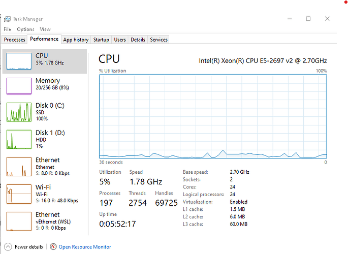

I have same results. The docker version are much faster then windows version. 2-4 times faster. sometimes, the windows version just can’t finish any project after 24 hours.
Mine is old computer with 256G RAM.
I think the windows version still have some big problems. If I start windows version, it just start to run out all 256G RAM. Now I have few times can really get into windows version so far.
What is your CPU? If you aren’t using an Alder Lake CPU, you probably are not experiencing the same issue Marko is.
I only talk about the speed.
just run another set to test both docker and windows version.
Docker, finish in 1h16min.
docker
windows 1h 50min, still running, looking only 10% finish.
web
CPU and RAM has a lot of extra to use.
