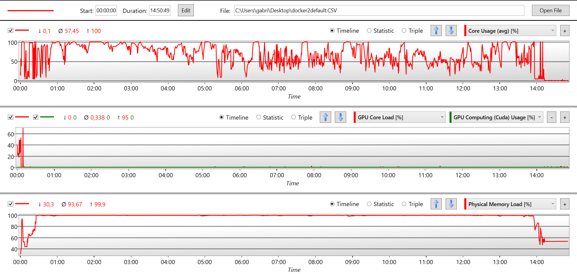

After some testing, this whole problem might just be me misremembering, I’ve tried testing docker webodm to get some more data, but I constantly am getting worse results. Not sure if it’s something wrong with my docker/windows installation, but it always uses all the ram and no GPU when processing the same data set as the one above. Here is a graph of the resource usage:
I’ve also ran more tests than this one, doing things like reinstalling docker and odm, smaller datasets, and different setting, but no noticiable difference.
I’ve done a little research on cuda through docker on windows, but it seems like it’s more complicated than just changing some settings, and currently I don’t have the time to learn this. So this might be it for now. If I make any progress, I’ll reply here.
