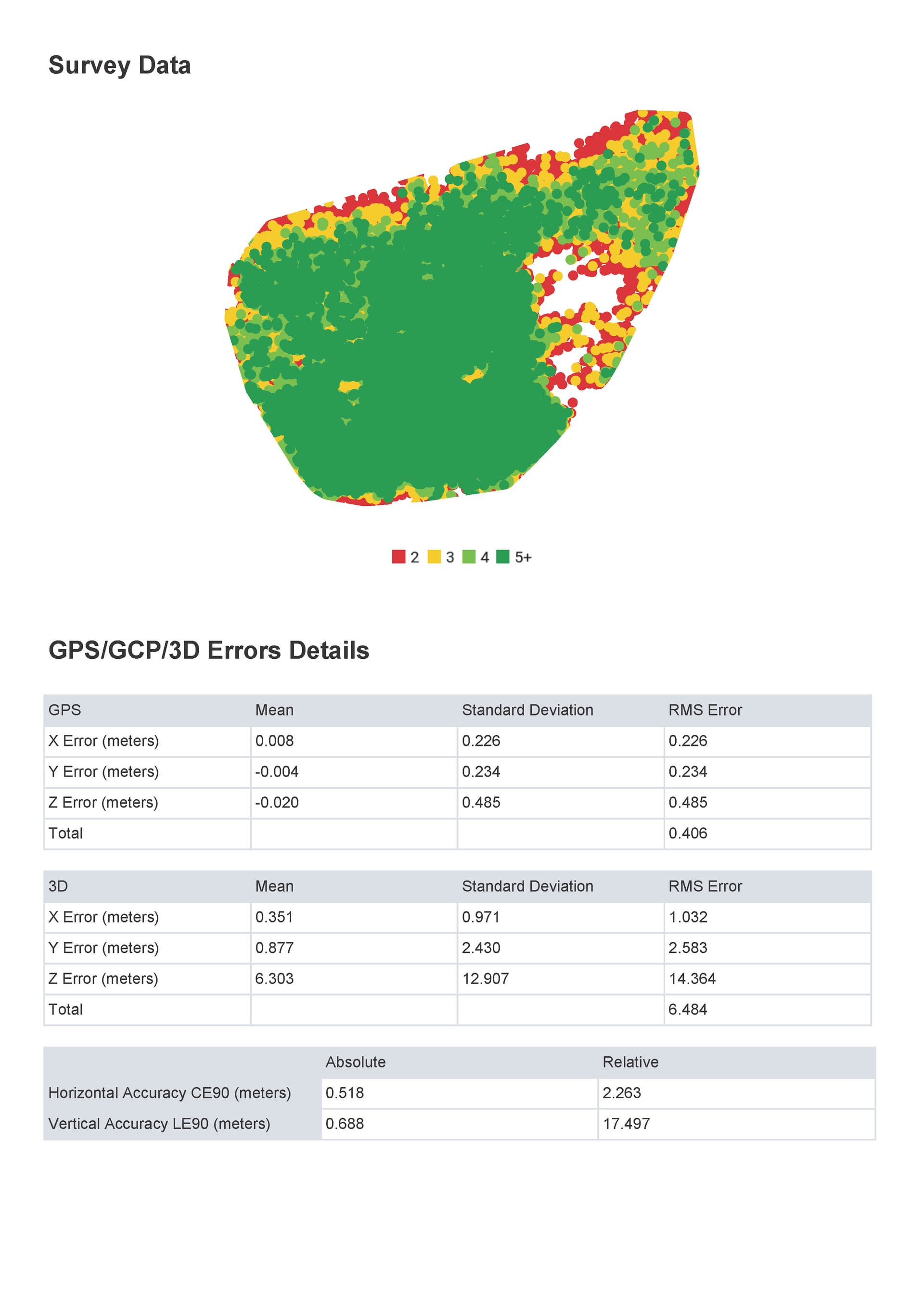

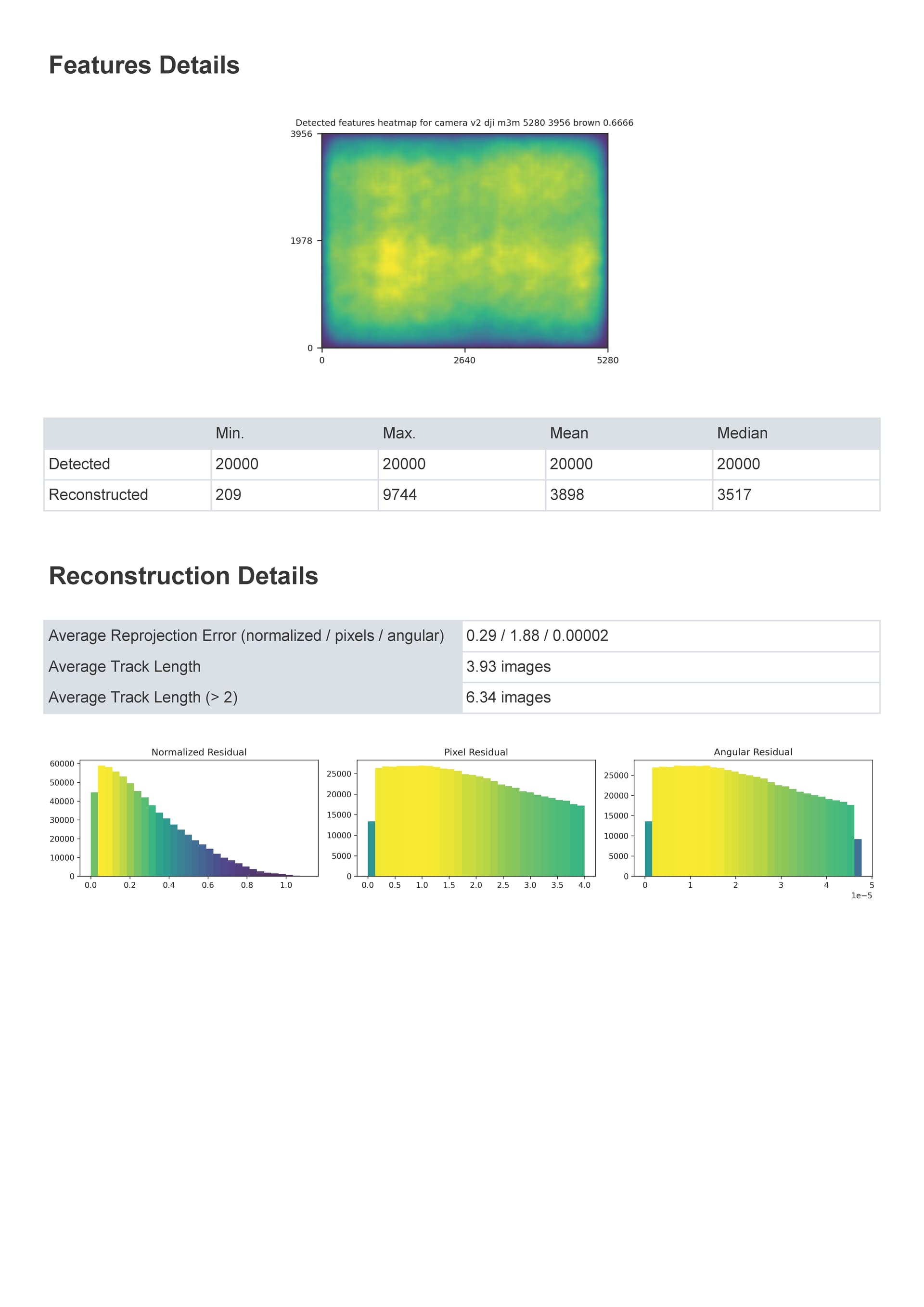

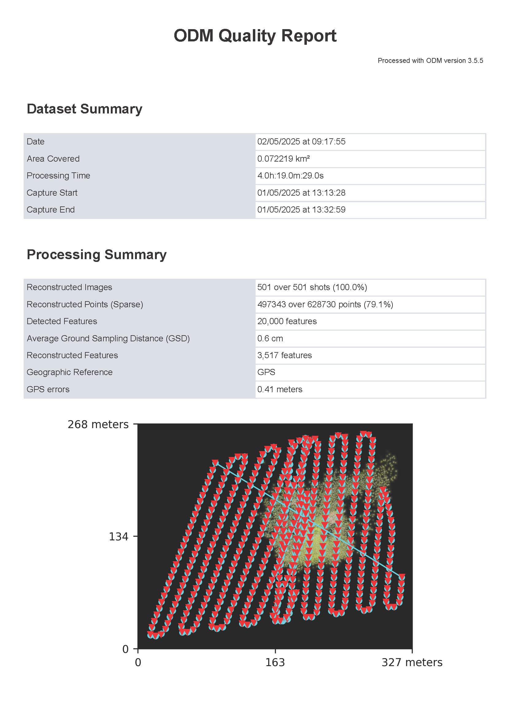

I did a forestry area yesterday with my DJI Mavic 3M. At past I did a flight with 90 degree nadir and a second with 80 degree and 20deg. angle of route for a orthophoto. Now I must fly a area and part this in two separate areas. In DJI I will get two folders like before. Now I will create a orthophoto and render 501 JPG images. I´ve open the folder, group these two folders in a subfolder and select only all JPGs for import.
After 4 hours processing I will get an ortho with half of my area? The routes are slightly changed in angle, but same altitude and GSD.

I think it´s auto-boundary:true - ???

Any chance to process multiple missions in one task? My areas (about 10) are all with different flightdirections, but all at same altitude and from same day. but different folders with JPG/TIF and RTK geotaggs. The areas are all overlap to each other with about 20-30m.
