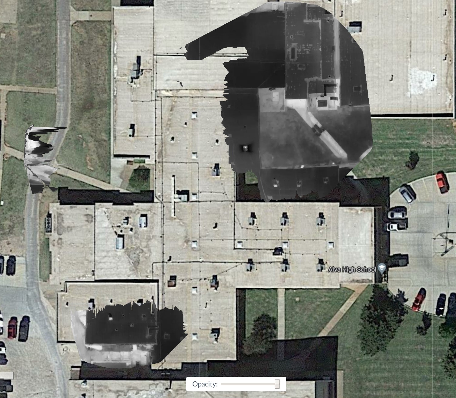

New to ODM and having some trouble. I have sucessfully created an ortho map from my XT Dji thermal camera. I cannot seem to do the same with my Mavic 3ET. Tried all kinds of settings. I am not sure what I am doing wrong. Only some of my cameras are being used to create the image. I just am lost. Been working on this for hours. Any ideas? Thanks a million for the help!!

s? Report attached and image of output
Hi Ern,
Can you share your processing logs (report is helpful, thanks!), your flight height, the height of the building, and your overlap? I suspect this issue is lack of overlap on the taller portions of the building based on what I’m seeing in the report.

I flew at 100 ft. Building probable 30ft tall i suspect Overlap was at 55%. I tried using a grid pattern too (i flew this building twice for test purposes)…but that would not process either. Really weird.

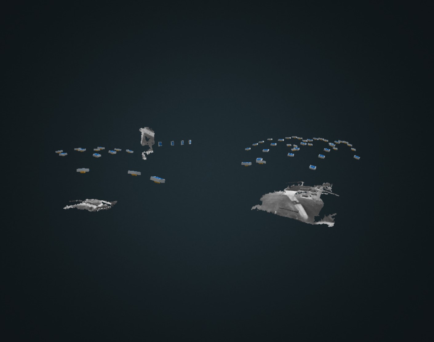

The 3d view reveals some strangeness as well…
Only using about 40 of my camera shots

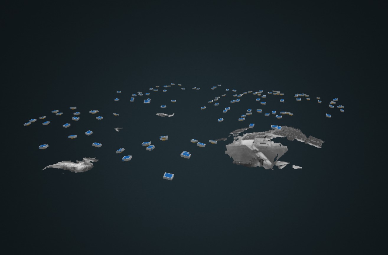

This is one flown in a grid pattern. More detail but still a mess
Without enough overlap, you can get really messy data, as the algorithms don’t have enough information to construct something sensible.

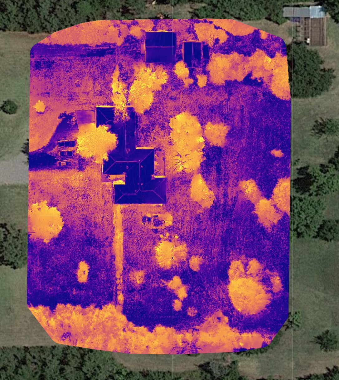

This is a job I did several years ago using the XT Dji Camera and Inspire 1. Overlap in the 50 range.

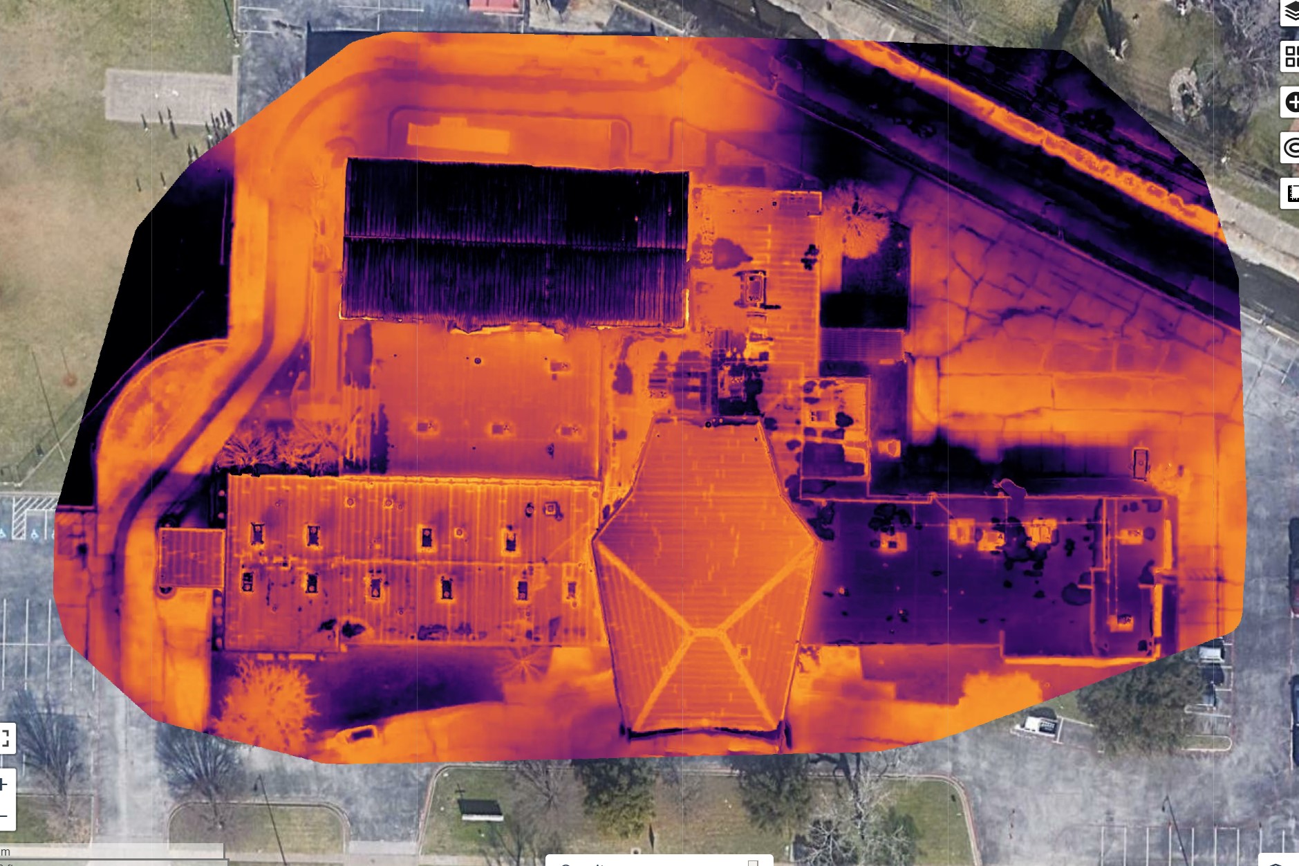

So I took everyone’s advice and went to 80 overlap. Get a look at this! This will be perfect in the field!
98 Images…150 Feet AGL
