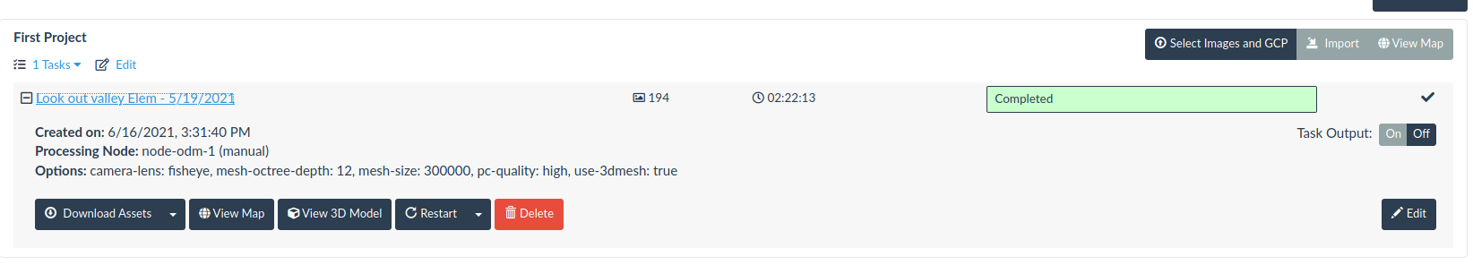

Yo, I’ve got an interesting project that I took on. I’m trying to map the interior of a building with about 4 rooms total. I used one of Gopros 360 cameras to capture the data, and I was able to convert the raw fisheye photos into a set of rectilinear imagery. I am currently trying to process this data set with these settings.
task|690x289
Does anybody want to give this interior set ago?

Do you have the raw photos? ODM supports them.
I have them, but there in fish eye
That’s fine. Just pass --camera-lens fisheye as an option. ODM takes care of the rest.
As long as they are full 360 fisheye, they are usable as is with the above option. Then ODM (via opensfm) will automatically convert them to 6 cubic faces for further processing.
