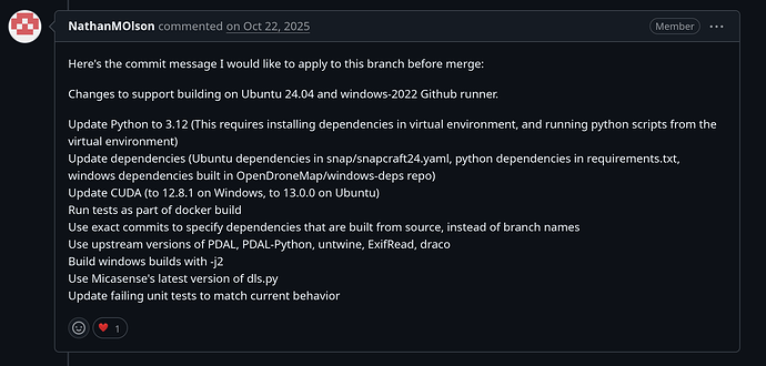

With all those libraries and the challenge of keeping / bringing them up-to-date, in Mid-2025, @NathanMOlson was kind enough to dive in and update and upgrade the stack in order to support building our docker image on Ubuntu 24.04. I did my best to support that upgrade with extensive testing through the end of October. We’re waiting on final release and deployment now that Leonardo has joined as OpenSfM / ODM core maintainer (more on that below), but the work Nathan did should both help with upgrades and updates moving forward and improve our security / vulnerability posture within the project overall.
You can follow along on that continuing upgrade process in this thread. A rough play-by-play of the upgrade and testing process process can be found within.

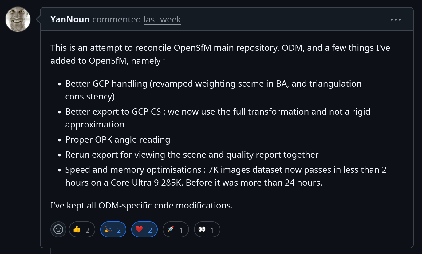

OpenSfM, 4 years newer
OpenSfM is the core library underpinning OpenDroneMap’s ability to do structure from motion, i.e. turning arbitrary images into 3D structures. Pau Gargallo started OpenSfM just prior to joining the computer vision Mapillary, which later was acquired by Facebook/Meta. OpenSfM became a core project in the early Mapillary experiment, and also has underpinned OpenDroneMap since early on, with both project co-arising in the late 20-teens.
Yann Noutary, core OpenSfM developer, in his down-time between working for titans of mapping and metaverse showed up to breath some extra life into the project and ensure that OpenDroneMap could be a beneficiary and benefactor of the OpenSfM moving forward. His fixes and enhancements included the following:
This was a monumental lift and points us in a good direction for upgrade and forward movement on the core photogrammetry tools.
On a call with @DodgySpaniard and me, he expressed his motivation in doing so: with the slow-down of OpenSfM development over the last 5 years, he had lots of pent up energy to do all the interesting projects, and was relieved that OpenDroneMap is still here making an impact using OpenSfM. While he had downtime, he wanted to contribute those ideas back.
This also helps queue OpenDroneMap up as the maintainer of OpenSfM moving forward. You can follow along with some of that conversation in the thread on @DodgySpaniard coming on as OpenSfM Maintainer.

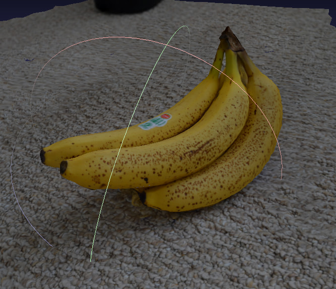

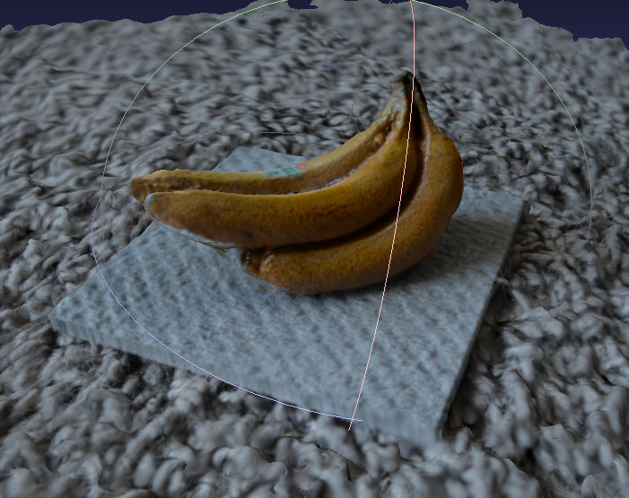

As a token of our appreciation for his years of ODM maintenance, we awarded Piero Toffanin the “it’s bananas to be a free and open source software maintainer” award.
We 3D printed a full color reconstruction of his test dataset of a bunch of bananas with a note of appreciation.
It felt like a moment of deeper understanding when he then created a test dataset from called Banana Inception.
I strongly suspect that the 3D printed bunch of bananas is sitting on the same carpet as the original bunch, adding to the inception element subtly and substantially. I’ll be honest, I have had to resist the temptation to print the inception model and send it too.

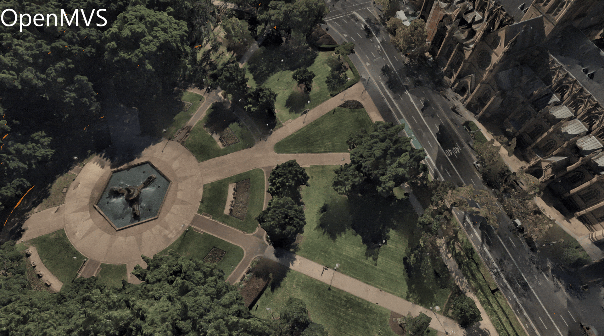

As far as critical libraries, the primary memory bottleneck for most OpenDroneMap processing is the texturing step where we take the individual photos from a dataset and “paint” the pixels back on a 3D mesh representing the scene. MVS-Texturing is the library we use for this work, and while it is quite a clever piece of software, it wasn’t designed to do the scale of datasets that are commonly processed with OpenDroneMap. It also isn’t as actively developed as it once was.
Developer Lead
In order to solve this problem and improve another upstream library, we engaged Dan Cernea of OpenMVS to replace MVS-texturing with a new OpenMVS texturing module that should both improve the quality of model texturing and reduce memory footprint. This is also expected to include improvements to texturing in cases where there are moving objects in the scene. Development work is ongoing but well underway, with basic functionality in place for mesh texturing with active development on the orthophoto weighted version.
new_year_texturing_update
Approach
We describe the approach here and development progress we document on an ongoing basis here.
Cost
Total cost for this project is $32,000.
Timeline
We were hoping to have this project out the door in 2025, but it’s been a combined research and development project, so it’s taken a bit longer. Basic implementation is now in place. Orthophoto weighted portion is now well under way, and we expect a testable development branch before the end of first quarter and likely in the next few weeks.
