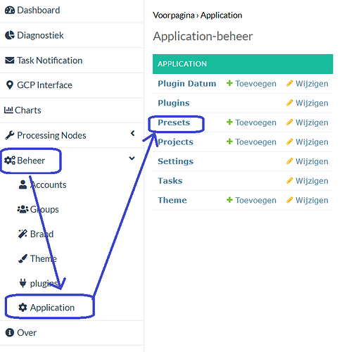

You can see in WebODM what these presets are. You can even configure your own :slight_smile:
  1. Go to

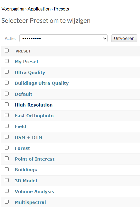

  1. Open a preset from the list
  1. The preset: High Resolution contains of several “Options”. For example: “orthophoto-resolution” is the output resolution when using this preset.
If you want to know what these Options mean, have a look at: Options and Flags — OpenDroneMap 3.5.6 documentation
You can also create your own Presets.
