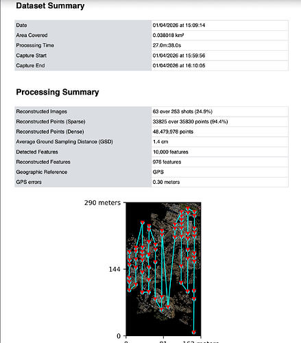

We have already been making quite some maps with WebODM without any problems. However one specific site has given us some problems. The first time we went we did a flight and we got a perfect model.

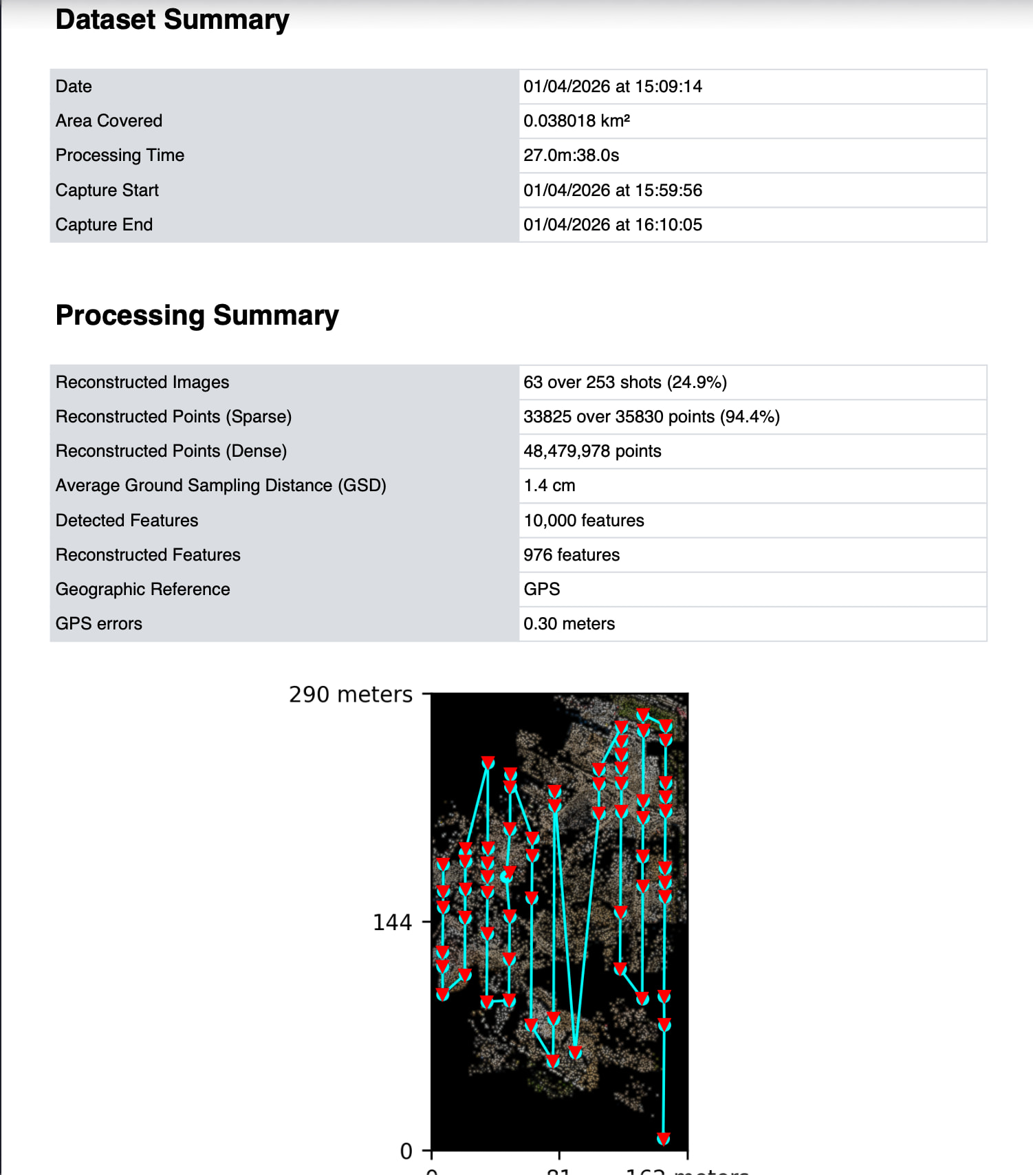

However the second and third time we went we had an interesting problem. The flight went without issues and we captured a good looking dataset with 80% side and front overlap. However after processing we saw holes in the model. After analyzing the quality report we saw that only 24.9% of the images where used. Also the camera positions of the images that are used are off. Some have for example a different altitude while the entire flight was flown at the same altitude with RTK.

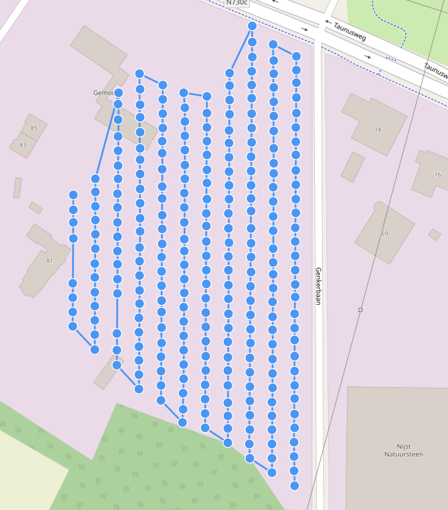

Interestingly the flight plan between the first flight and second / third one did not really change. Also I processed the same flight in PolyCam and that processed without issues.

My suggestion would be to take subsequent images with a consistent gimbal pitch. if you want to take images with a -60 gimbal pitch that is ok, but take those image in another pass of the site.
