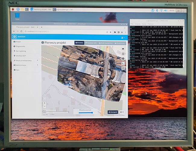

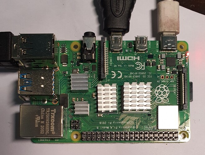

I installed webODM on Raspberry Pi 4B 4Gb via docker and 64 bit version of Raspberry PI OS and it works. (Instructions as from debian)
Of course, it’s completely unsuitable for counting projects on this little computer, but importing an already counted project works. It displays slowly on Rapsberry but if I run webODM from Raspberry on another fast machine and we only browse this project over the internal network it works pretty well.
Unfortunately, I can’t make it available to the Internet outside because I don’t have a fixed IP. However, you could use this raspberry 4B as a server to share simple projects with clients!! Maybe I’ll get a permanent IP and somehow share it soon. With Fixed IP, it should be able to share outside the home network. I don’t know how to configure internet and ports but I will try.
