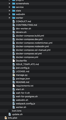

As I’m able to open the Application and inspect its package contents, I just need some hint where I’ll have to look to rewrite/update the “false” Debian Docker image downloading information.
