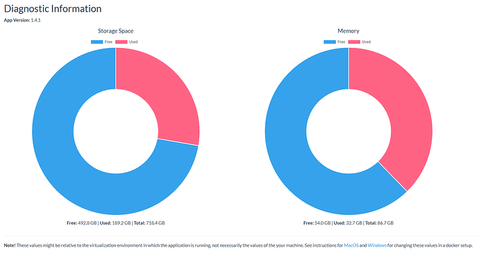

16-core, 32-thread, 128gb (not fully allocated to Docker). I don’t think I am running out of memory, see attached screen shot…but something is off for sure…

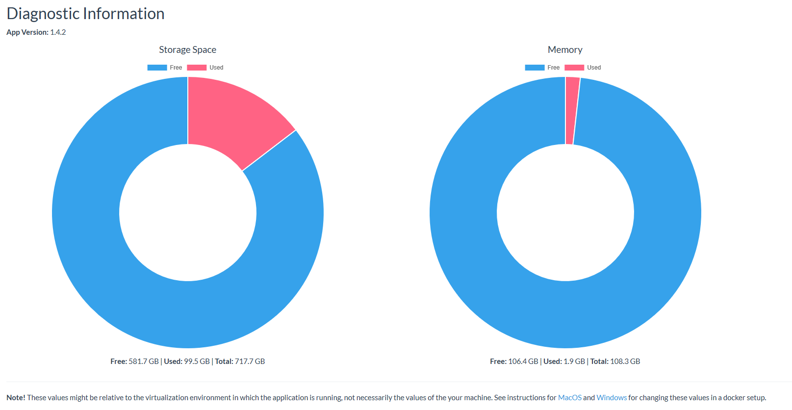

Unfortunately, I think I have discovered that ā€œdeletingā€ in WebODM is not removing items from the hard disk and/or the virtual environment. See two images attached (note when I disable Docker, free space on the C: drive increases from 322GB to 435GB (slightly larger that the 99.5GB used shown in diagnostics…but there is still hundreds of GB somewhere). Note, other than the OS and a few small programs, this drive does not have much else on it. Are there any tips on an easier way to find the files / do file cleanup?
