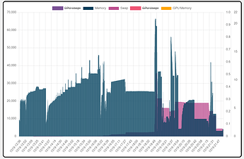

Just wanted to add this picture:
The picture shows a rather typical ODM run on my system. The blue bars are physical memory, the red is swap usage.
You can clearly see that for most of the time the physical memory is enough and only at some points the system has to rely on swap. But the red bars towards the end are just swap that isn’t cleared, means there is not intensive swap usage anymore. The intense swap usage, measured by monitoring NVMe storage activity, is during the tall blue spikes.
I think that picture shows why the   memory x 2 = swap amount  is good equation to go by :cowboy_hat_face:
If you would have more memory, it would idle most of the time.
