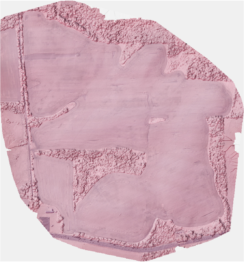

Add both DEM/DSM and Orthophoto to a QGIS Project first, as they are both needed or either workflow.

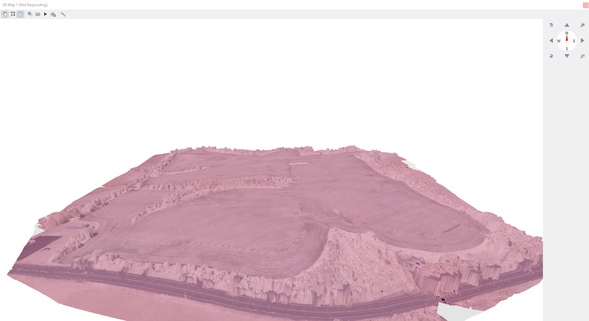

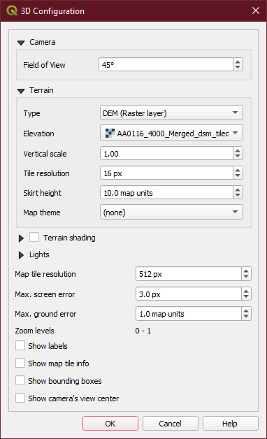

3D View

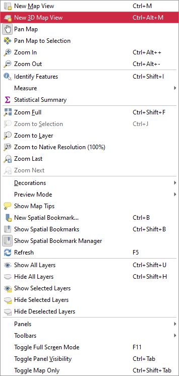

View-> New 3D Map View
Settings on 3D View → Type DEM, Choose your DEM/DSM as the Elevation layer
You can tweak with settings here and really break things, so avoid doing so for your first run

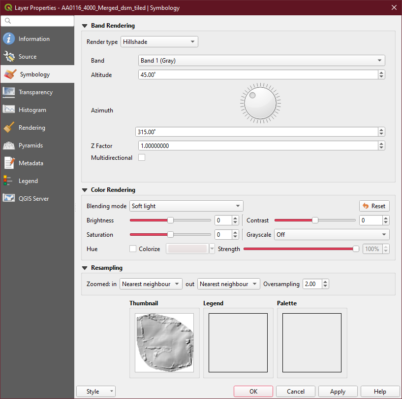

Hillshade
Move your DEM/DSM Layer on top of the Orthophoto Layer
Properties → Symbology → Hillshade
Properties → Symbology → Blend Mode → Soft Light
