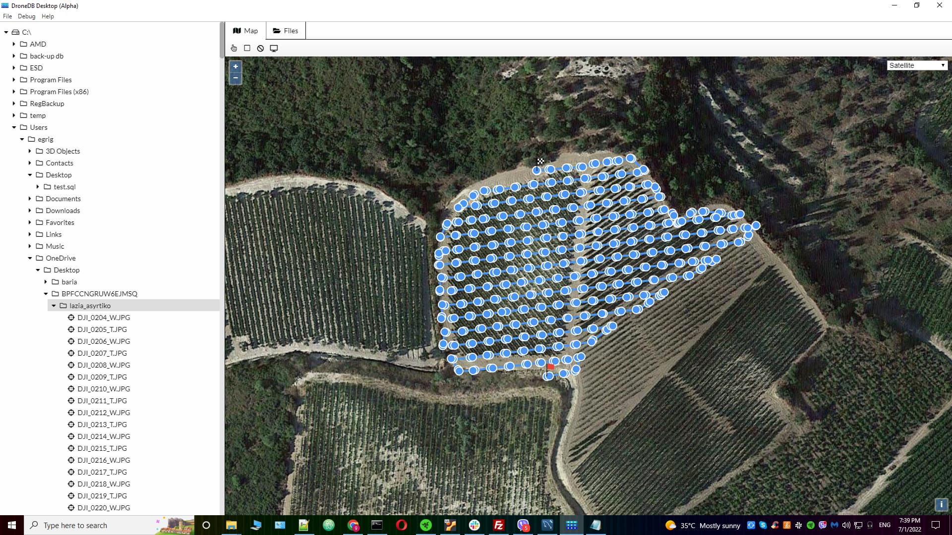

And the drone db image:
Any help about where the problem lyes will be great .
