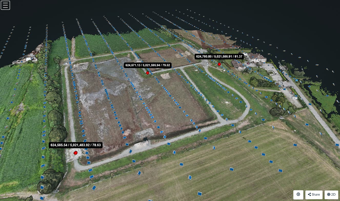

Problem
  • The reconstruction is accurate in planimetry.
  • However, the resulting model is systematically 0.7 m lower than the independent Leica checkpoints.
  • The offset persists even after checking all conversions and ensuring both drone altitudes and checkpoints are in the same vertical reference.

I don’t know, it doesn’t seem to be my case. Moreover, the geodetic elevation at takeoff is about 79.7 meters, and given the flight height of 45 m it would be 124.7 - 45 = 79.7. Aside from decimals, the altitude recorded by the drone and then converted seems consistent. The second point on the west embankment is the GCP, which should be 79.5. From this and other points I deduced that the model seems to be shifted in Z by -0.7 m.

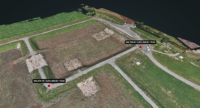

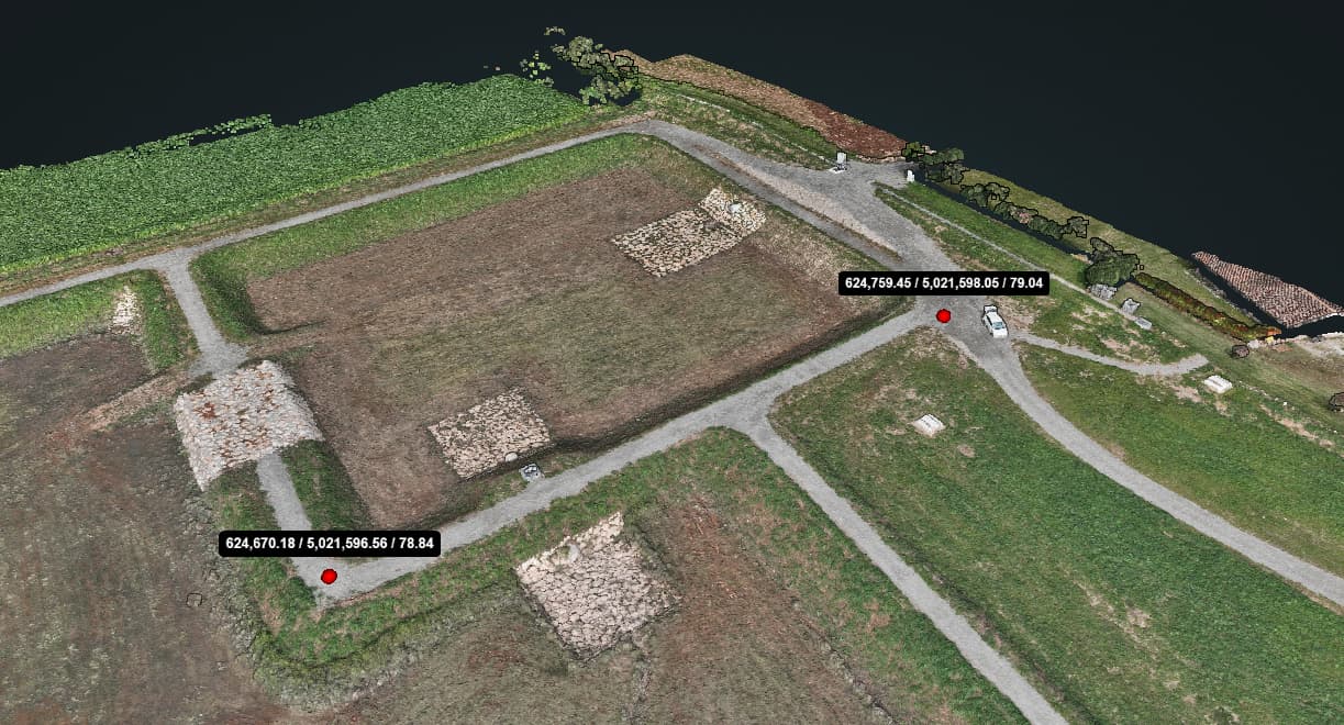

Thanks to everyone who took the time to reply and offer suggestions. Over the last few days I have been running more tests to better understand what is happening, and something quite clear has emerged. When I process image sets that contain oblique photos, the reconstruction aligns correctly in Z, with no sign of the ~0.7 m bias that I originally reported. The offset only appears when I use slightly off nadir (-85) imagery.
With oblique datasets the stronger geometry seems to provide enough constraints in the vertical direction so that the final heights are consistent with my checkpoints. With nadir-only datasets, instead, the weaker geometry does not fully constrain Z, and the systematic offset remains.
As you can see, when using the oblique function in Pilot 2 an excessive number of photos are taken (996 compared to about 400), so I will try some tests to get the same result with a manual flight plan, for example: a nadir flight with 60/60 overlap and a second pass at −45° with 80/70 overlap.
