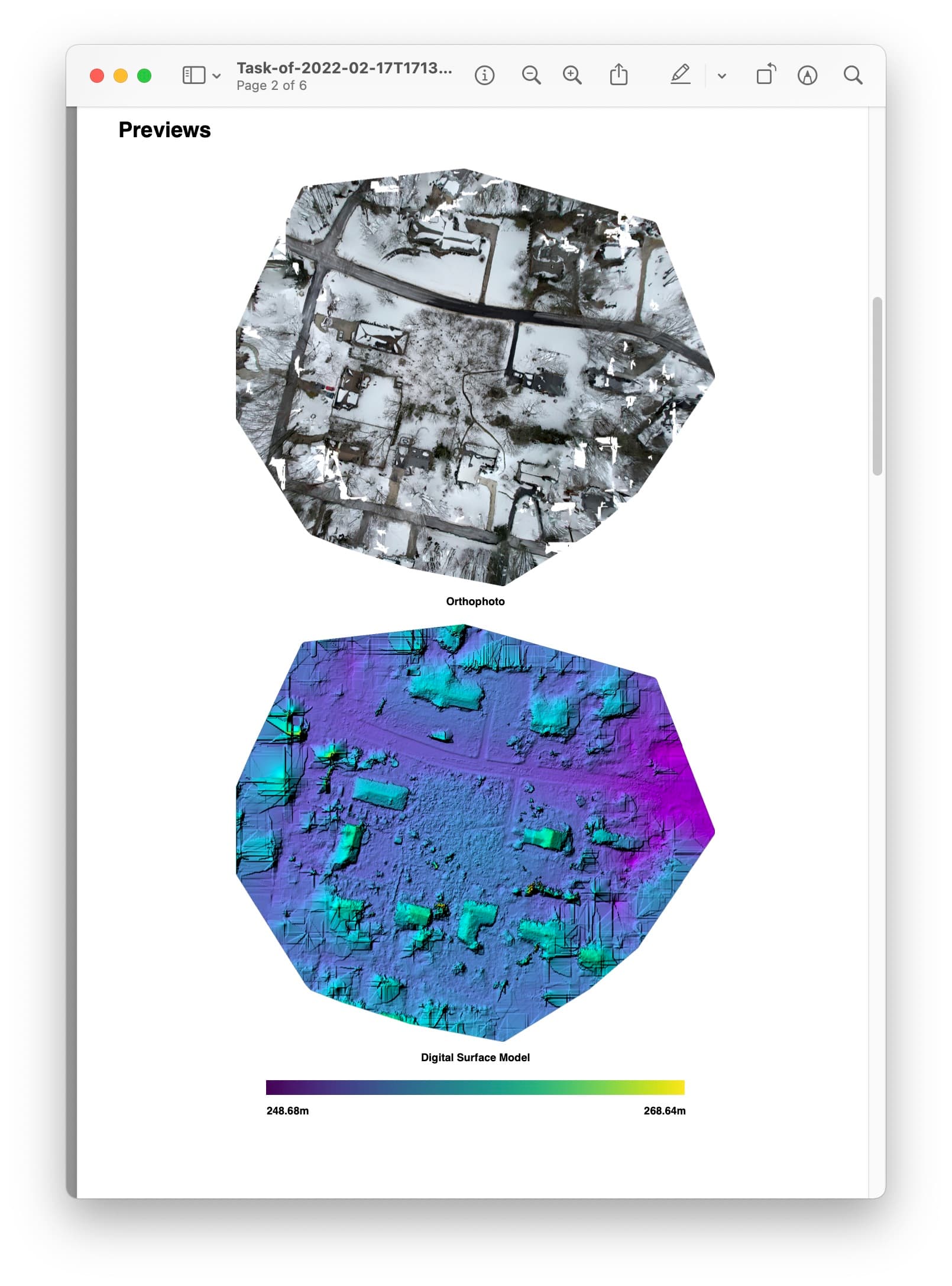

I processed my aerial images (36 jpegs to keep it simple) and it yields a good 2D map, but get blank screen when I try to view 3D Model. Have tried searching the forums for solution. The “Full Extent” button that has worked for some people with this 3D-not-displaying-issue does not fix my issue. I have also tried in both Chrome and Firefox. I am running an M1-chip Mac Mini and using the build designed to work with the Apple-chipped (M1) Macs. My 2D display and ODM Quality Report pdf does show what appears to be a fairly accurate Digital Surface Model, so I think the 3D data is in there somewhere(?) Any help is appreciated. Thanks!
p.s. Since I am a “new user” I could only put one attachment jpeg on this post.

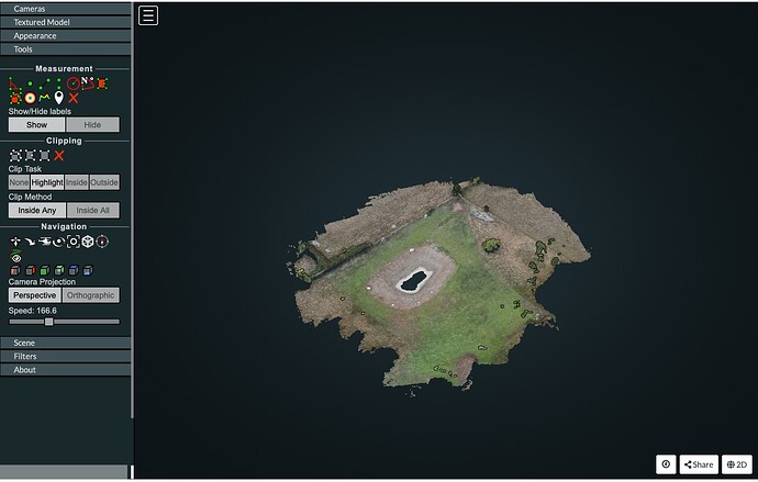

Here is a quick example using the default settings on a dataset I had handy. All I did was import the images, click the button to start the job, then click the View 3D Model button.
I’m running Safari Version 15.3 (17612.4.9.1.8) for what it’s worth.
Oh! I updated WebODM before starting the job – it’s now at version WebODM 1.9.11!

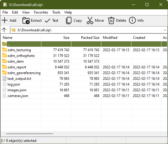

Did you submit the job via the Lightning Dashboard:
If so, it doesn’t enforce the --pc-ept flag, which is required to view a 3D model in the WebODM interface via PoTree.
Uploads via the program will, however, enforce the --pc-ept flag.
