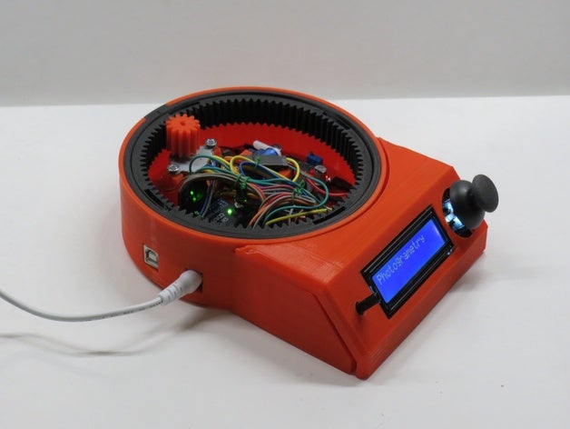

I don’t have time to play with this, but I’m wondering if anyone in the community is interested in building a turntable like this and testing it out with OpenDroneMap? I’d be super interested to see how it turns out:
Looks like it’s just a print, a bluetooth remote, and an arduino kit:

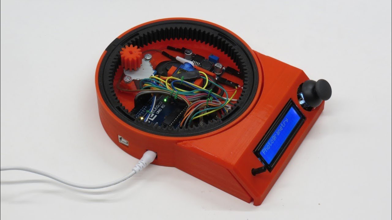

Hmm, there’s also this: https://en.openscan.eu/

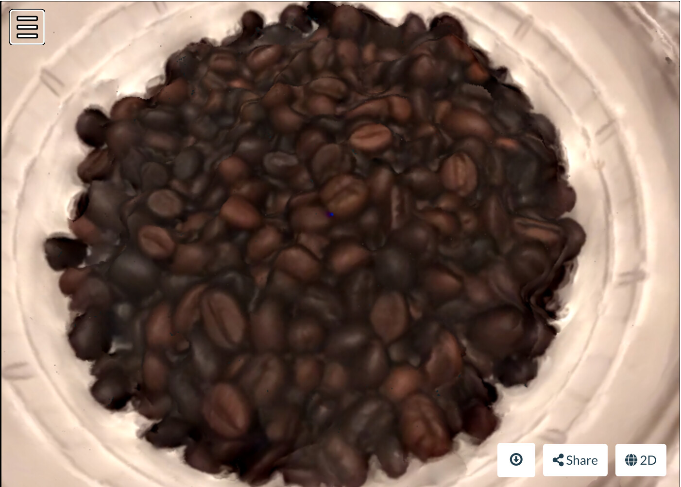

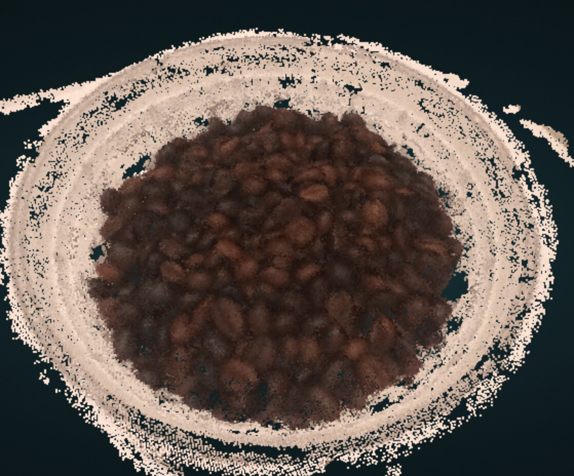

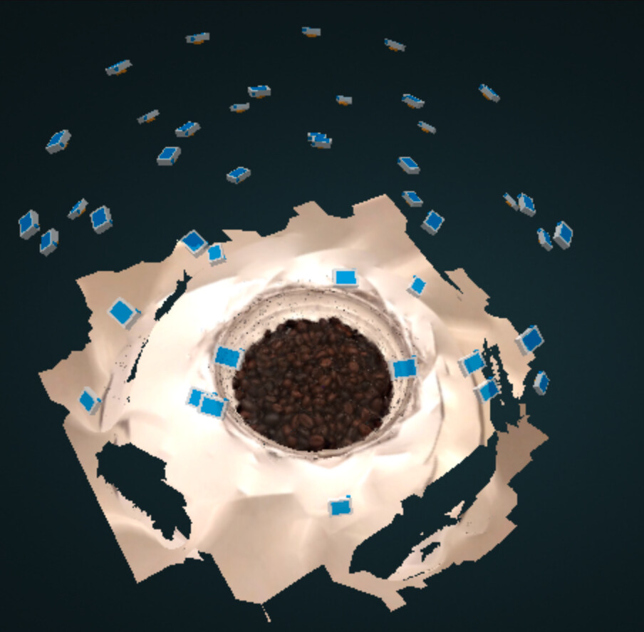

Used a potters wheel, one light above, but moderately even lighting, and slow-mo mode on the old cell phone camera:
Confirmed:
https://webodm.cmparks.net/public/task/ddd681e8-8c21-49da-b107-fa9605c92003/3d/
(I was too lazy to mask)
