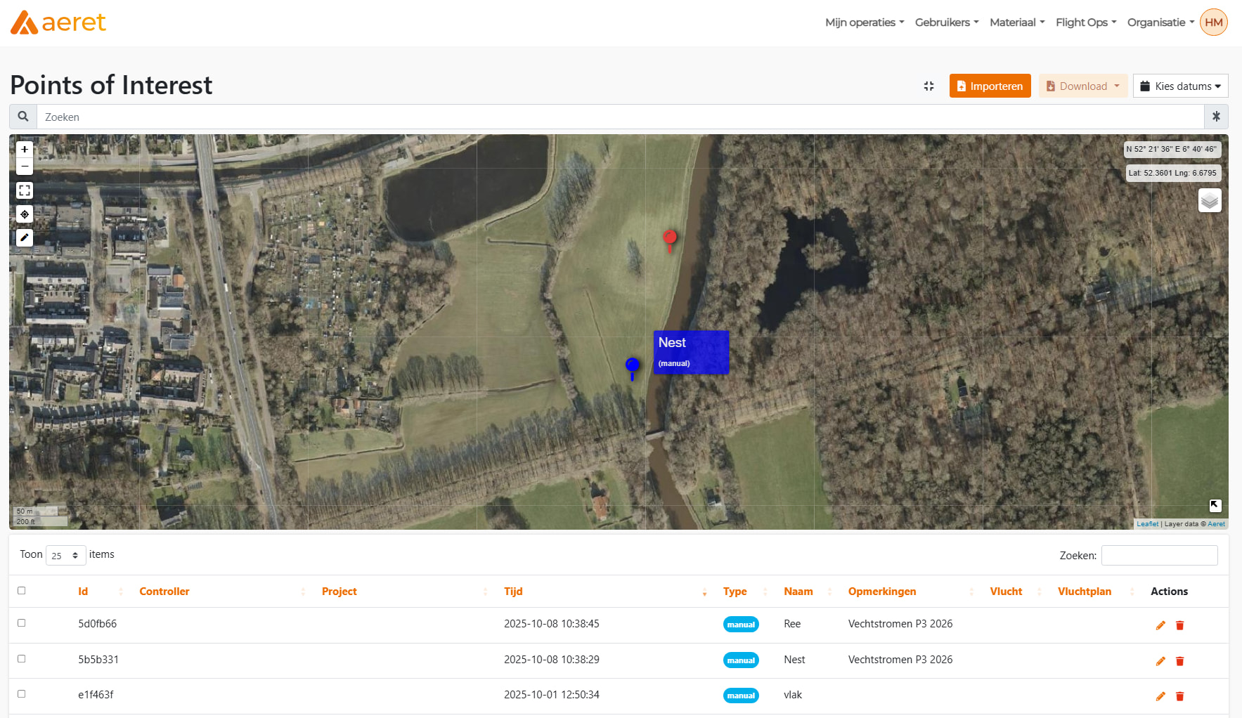

Example
The following is not meant as a sales pitch, just to show (data)possibilities. If this against any forum rules, feel fee to delete the following info.
In our own application we made a live sync between images and Points of interest. Pilots fly and images / POIs are plotted live onto a map. An inspector can use this map to navigate to a location.
More info about live sync video / images / POI : https://skysync.io/
More info about (Dutch) nature applications: Faunadrone - Robor Nature
