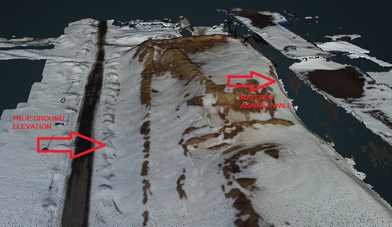

The measurement tool is very cool, but I have a new challenge for it and I don’t know how to acheive it. I have a stockpile, usualy it is very simple to calculate the volume by drawing the limit with the tool. In the case I have today, the stockpile is stuck again a wall and I would like to indicate that the base of the stockpile is lower than what ODM is thinking.
Huh! That’s quite a challenge…

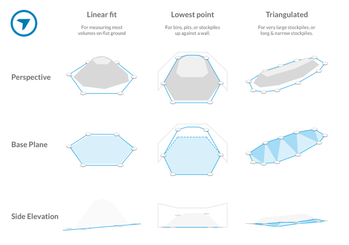

Usually, I use the stock measurement in Drone deploy but I am trying to use ODM at 100%. Drone Deploy have theses options.
How do you feel about those options? Do they cover all of your use-cases?
For me, the two options “trianguled” and “lowest” answer all my needs. I never use “linear”
We should have an update soon that addresses your Feature Request:
