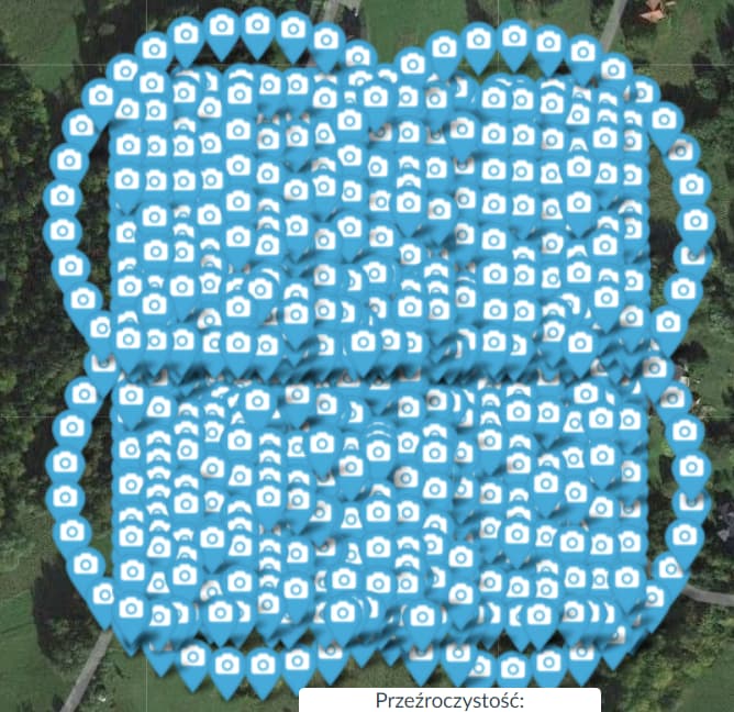

Hi! I have 4 image datasets of bigger area. Each dataset was separate flight consists of nadir and oblique (orbit around) images, it looks like this:

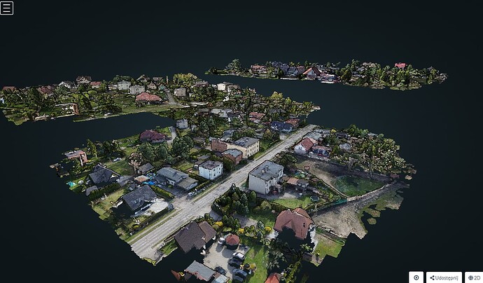

Single dataset:
Each dataset have about 200 images. I have created image_groups.txt manually - each dataset as seperate group, becouse with automatic grouping some submodels created was having about 300 images, even when I’ve set split parameter to 200 or even 100 (split-overlap was set to 50). I was also worried about my oblique images, if it will be properly grouped… That was too big for my processing nodes with 8GB of RAM

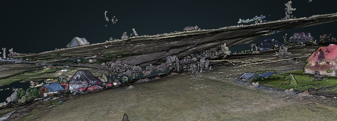

And the result looks like this:

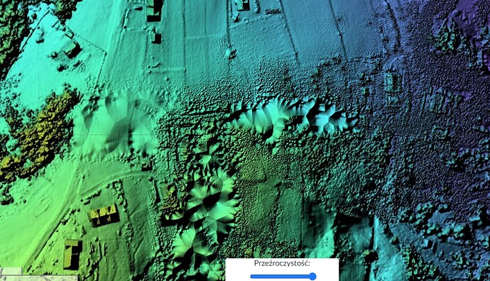

Otrhophoto and DSM are also broken:

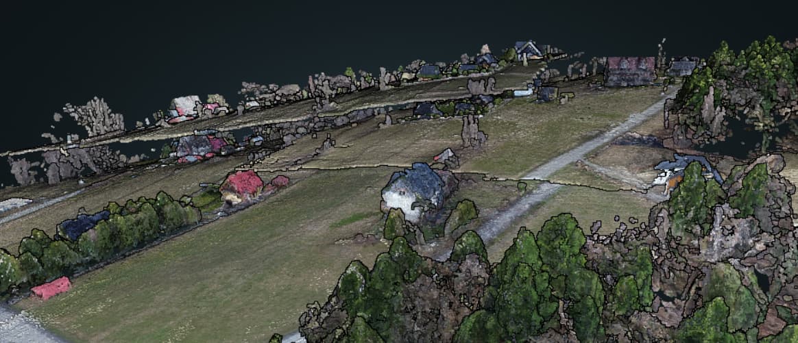

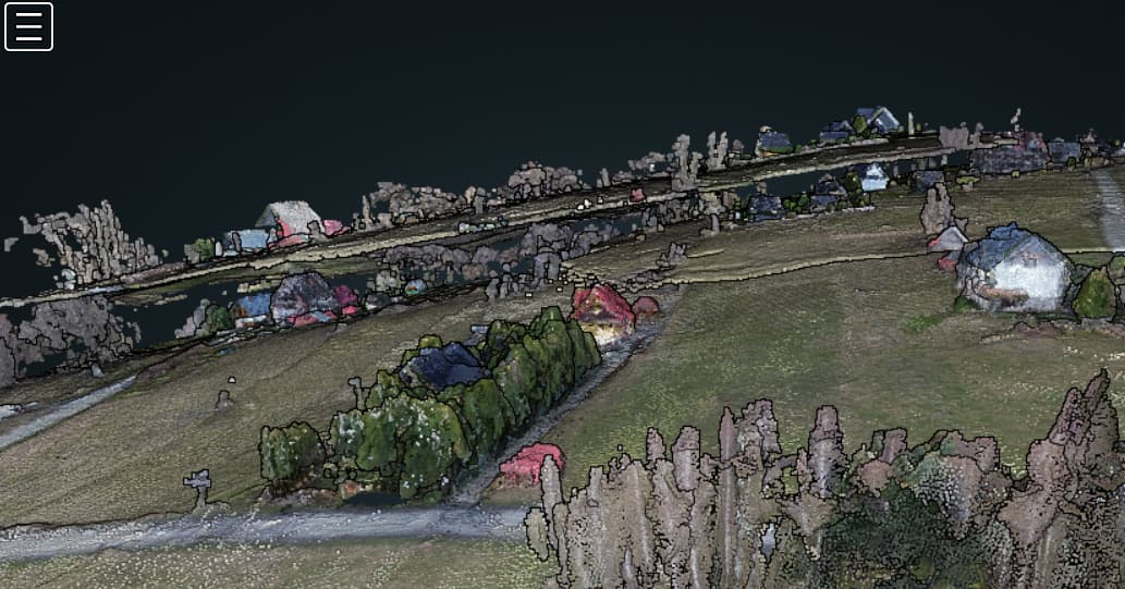

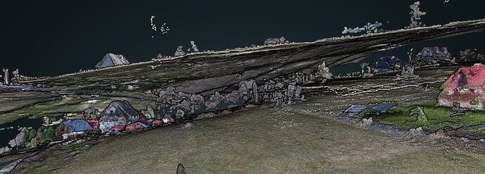

I’ve tried once more with suggested parameters - sm-no-align: true and gps-accuracy: 3. Same result as before, new pointcloud:
