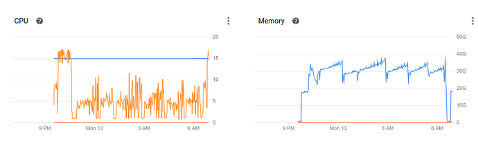

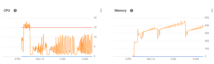

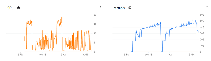

Just as informative info, see below of runs that have not finished yet. Data is 2788 images, each roughly 6MB.
Using --split 500
Using --split 1000
Using --split 1500
Also --split-overlap 100 and all other params are the defaults.
