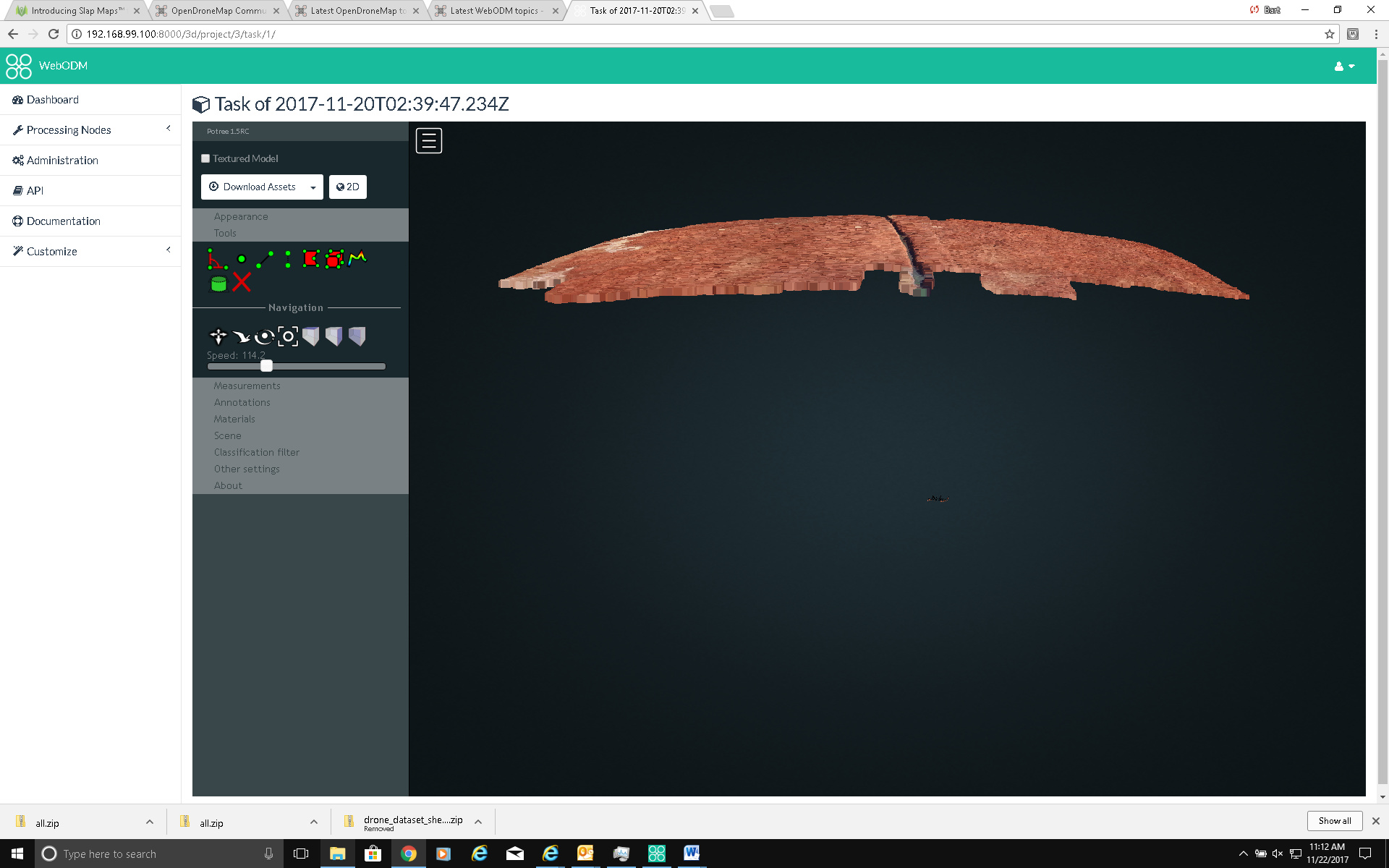

  1. In the 3D model, there appears to be a spherical warping of the surface that is not consistent with the terrain. This shows up in the small test data set as an upward arcing of the middle of the data set surface. When I run the larger data set, it is more obvious that the high point is in the center of the data set, with the rest of the surface arcing downward toward the edges.

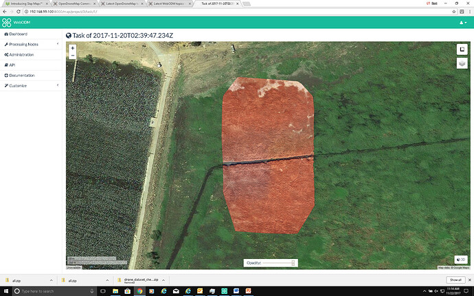

  1. There is a significant amount of clipping of the final orthophoto on the corners. This is not extreme in the small data set, but gets significantly more pronounced when I process the full data set.

  1. For warping, you might want to undistort your images before processing with a program such as GitHub - dakotabenjamin/CameraCalibration. We’ll probably integrate this process automatically in the ODM pipeline at some point, just haven’t had the time to do it yet.
  2. For clipping, see if removing both “–use-25dmesh” and “–use-pmvs” parameters gives you better results (leave all the others unchanged).

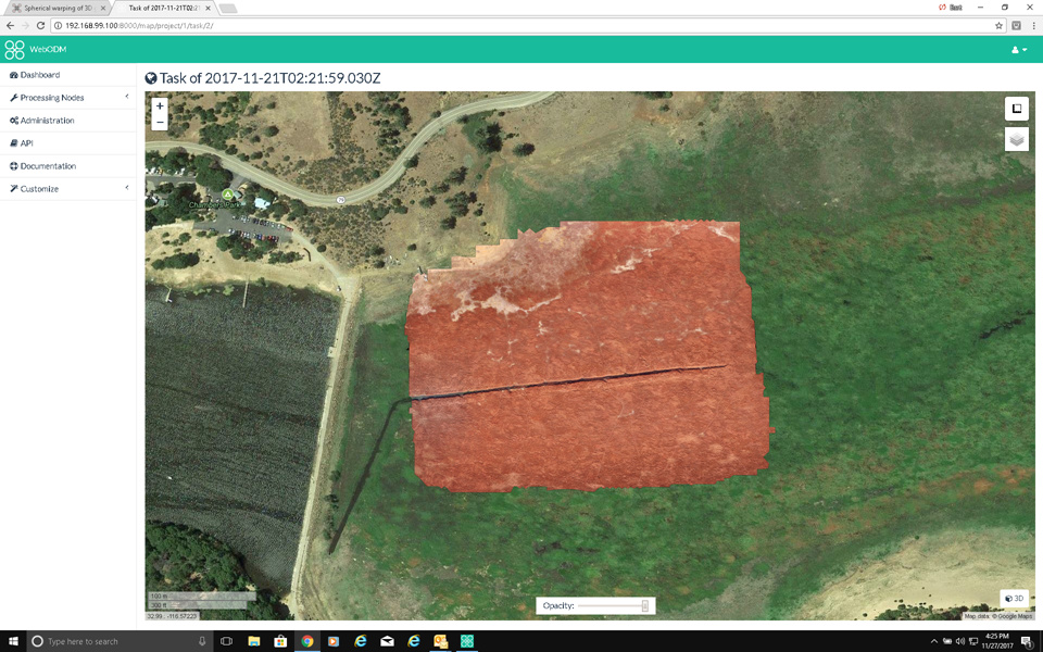

OK I retried this on the smaller data set (to save some testing time) and found that the clipping issue is resolved if I remove the “-use-25dmesh” but retain the “-use-pmvs” and no Code 1 issue. I will try this on the larger data set now.
It seems like the problem I was having before with the larger data set was related to memory settings still. I seem to have to go into the Oracle VM and set those for each session for some reason. At any rate, I was able to successfully complete the orthophoto mosaic for the big data set:
I am going to work on sorting out the warping now.
You can also avoid the warping by adjusting your flights:
  • make the camera point at a slight angle from nadir (7-ish degrees should work)
  • fly perpendicular flight lines (criss-crossing).
This will create converging camera angles which reduces the errors that cause warping.
Ah yes that makes sense! Will give that a shot for my next attempt. Thanks very much!
