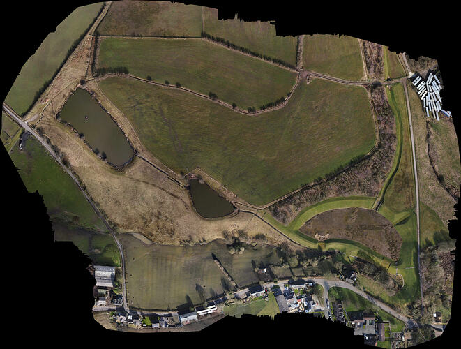

Just ran it on a couple of files, and this is the result

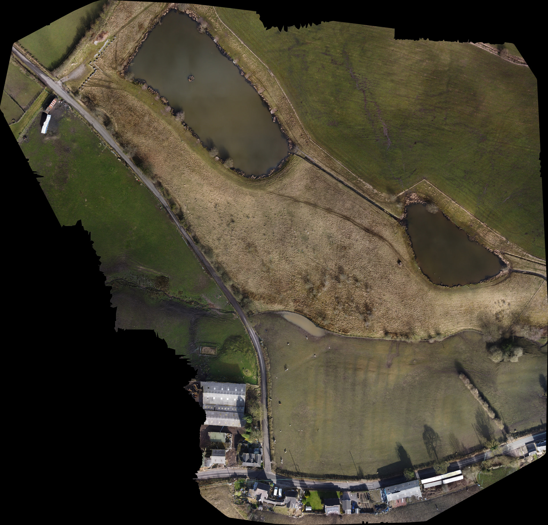

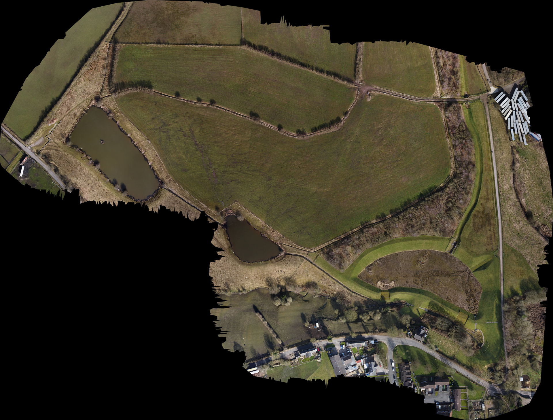

Here are JPG copies of the original files

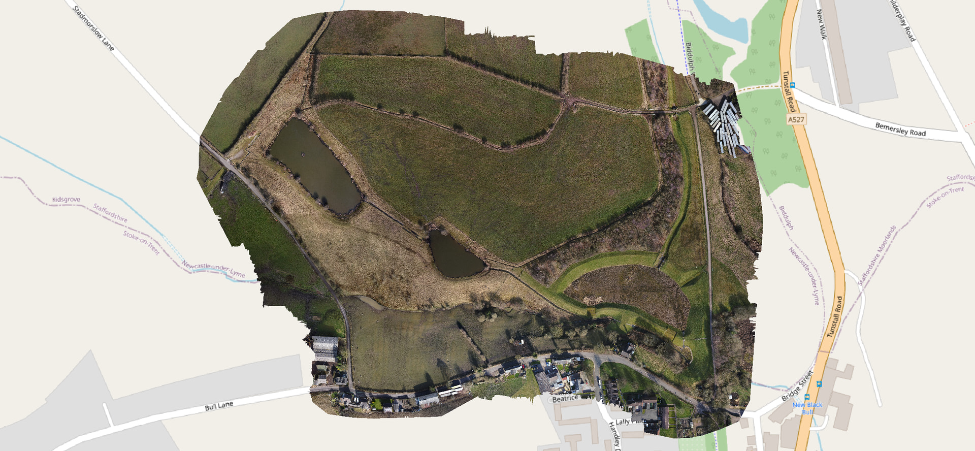

And here it is overlaid on Open street map

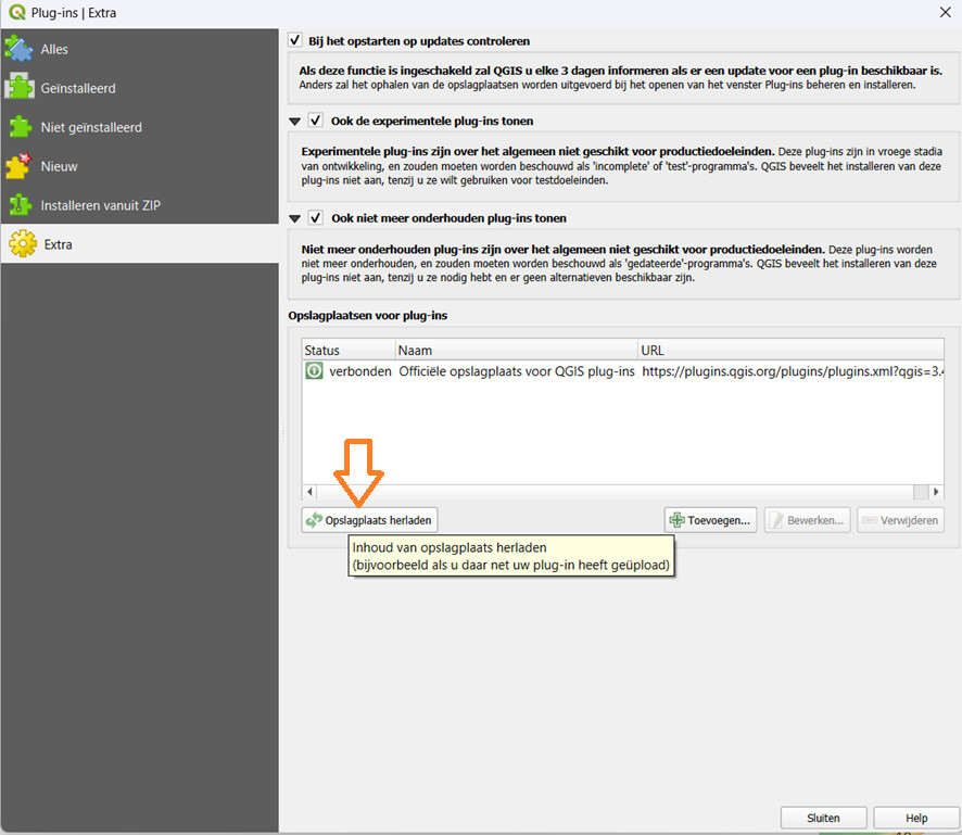

Now available from the QGIS Plugin Repository: QRasterMerge — QGIS Python Plugins Repository
Great! Just installed it. After refreshing the plugin repository it’s visible in the list.

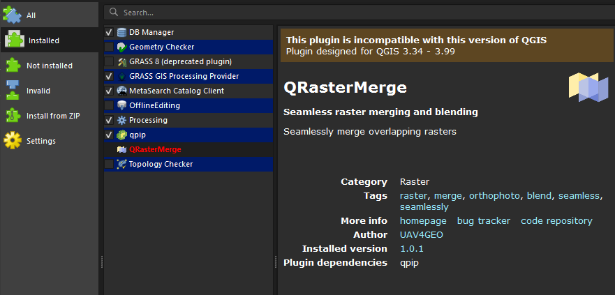

OK, just installed version 4 of QGIS and seeing this, also this message appears as a python error
2026-03-10T07:37:48 CRITICAL Traceback (most recent call last):
File “C:\PROGRA~1/QGIS40~1.0/apps/qgis/./python\qgis\utils.py”, line 475, in _startPlugin
plugins[packageName] = package.classFactory(iface)
File “C:\Users/mread/AppData/Roaming/QGIS/QGIS4\profiles\default/python/plugins\a00_qpip\_init_.py”, line 2, in classFactory
from .plugin import Plugin
File “C:\PROGRA~1/QGIS40~1.0/apps/qgis/./python\qgis\utils.py”, line 1082, in _import
mod = _builtin_import(name, globals, locals, fromlist, level)
File “C:\Users/mread/AppData/Roaming/QGIS/QGIS4\profiles\default/python/plugins\a00_qpip\plugin.py”, line 10, in
import pkg_resources
ModuleNotFoundError: No module named ‘pkg_resources’
