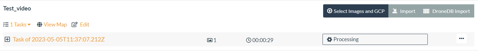

Thanks! Updated and WebODM is currently processing :slight_smile:
Wow! Hats of to you sir! I made a 360 around the bike from my son and WebODM made a nice 3D model.
