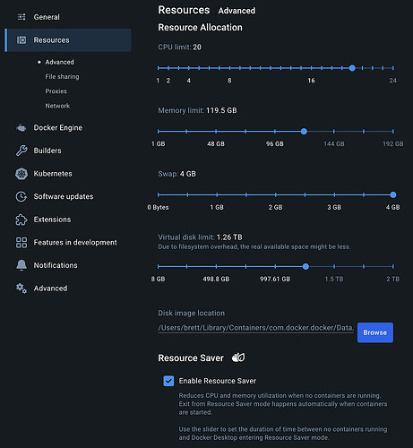

Within Docker I have changes Resources to take advantage of the better computer. I have set the CPU limit to 20, Memory limit to 121 GB, swap to 4 GB, virtual disk limit to 1.01 TB (Macintosh HD has 2.46 TB available with 1.07 TB purgeable, 593 GB used of 2 TB total).

Would it be helpful to see the Resources screen? I have varied some of these settings without seeing a change in the cut-off point.
Try increasing your Memory allocation and leave maybe 16GB to MacOS and try again after a reboot.
I appreciate the suggestion but I tried it (roughly, I will get to that) and it stuck in exactly the same place. I tried out as high as you suggested and received errors. I tried it again and again at lower settings, still getting errors. I moved back to 144GB and I was able to get the Docker Resources to load and Docker would restart, but it made no difference to how many files load in WebODM. I am still stuck at 80.4%.

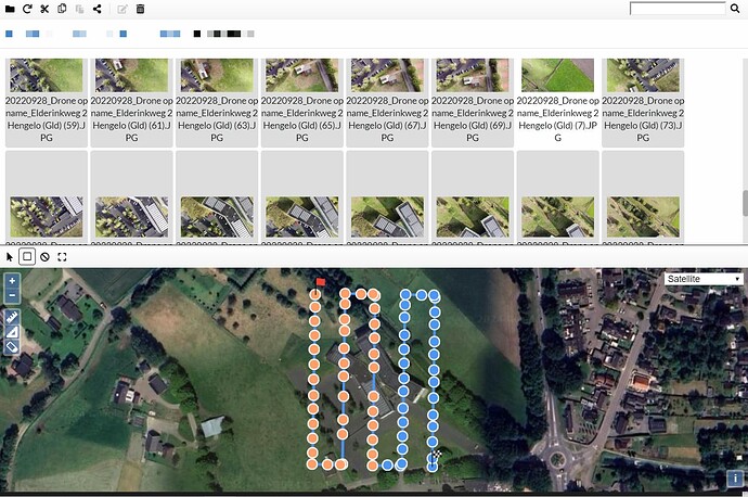

Maybe you can split the mapping in two parts? If you combine them in one project you can open them at the same time to see the orthophoto’s.
I don’t know how you performed the mapping (grid? double grid?). If it’s single grid it should be possible to select images based on name / image acquisition date-time. For double grid it’s nice to have an application where you can select images based on location.
With apps like DroneDB (Desktop) it’s easy to make a selection of images based on area.
