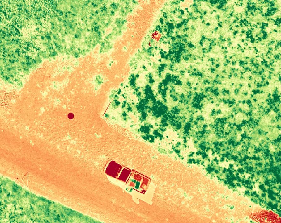

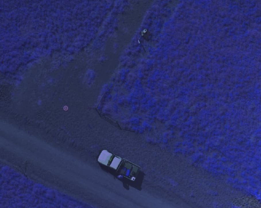

Hi Yario,
Thank you for sharing this script!
The results from my first test pre-processing with this script look great (screenshots below).
Cheers,
Ben
