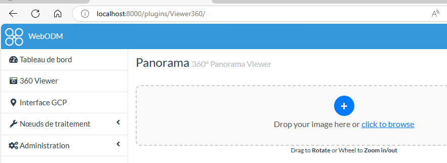

I am working in a plugin to view 360 panoramic images using three.js and panolens
For the moment, it is very basic, you can drag&drop images and it will open them, always, in within WebODM.

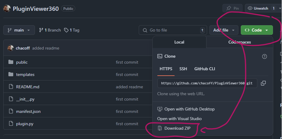

Hello Barry!, the installation it is pretty simple:
First, download the source code in a zip:
In webodm, Administration >> Plugins:
Load the plugin using the ZIP file with the source code you download from the repository
that should be sufficient.
good luck!
