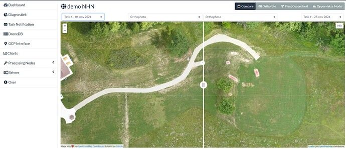

One can visually compare results in WebODM with a (new) Compare Tab.
For example Task X - Ortophoto with Task Y - Orthophoto
To make it a bit more visual I tried some things in Paint

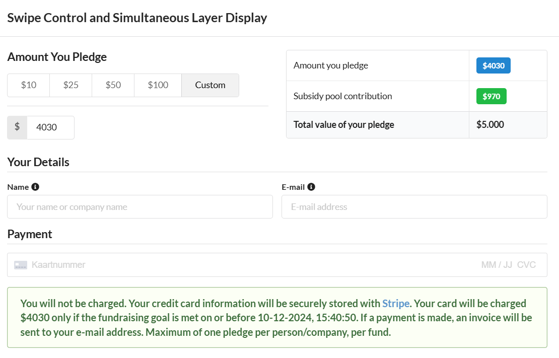

I’ve put together a fund proposal here, which people can contribute to: OpenDroneMap Funding - Quadratik
Feel free to share the link with people/companies that might be interested in sponsoring this feature?
I estimate this could get done before the end of the year with a funding push. :partying_face:

Three quick questions:
  1. Does this proposal end after 12 days? I’m currently asking in my network (already 2 organisations who are very interested) but 12 days might be a bit short for the organisations to get approval. I have to make a quote and invoice for them to receive payments/funding.
  2. Is there another way to make sure the payment reaches you / WebODM? For me (my company) it would be easier to work (justify) via a quote and invoice.
  3. For me the idea of pledging funds is new. Am I correct to assume that if 4030 dollar is ‘collected’ the ‘other’ 970 dollar will be added to the the pledge (making the requested 5000 dollar?)
  1. Yes, although there’s some flexibility here and we could extend the deadline if it means getting this funded.
  2. I can certainly send you a formal quote; just get in touch via Contact - UAV4GEO providing company name, address, etc and pledge amount. Once the quote is approved I can just register it along with the pledges in the system.
  3. Yes. See the “How it works” page on the quadratik page for details of how exactly that’s calculated.
