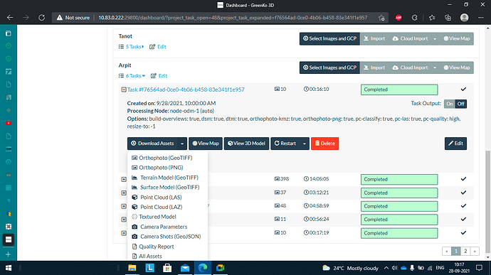

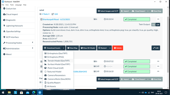

As you can see, I’m using the Orthophoto:true option. But still the .KMZ file is not available in assets. I also checked in downloadable Zip file.
I think there is some source code changes, to enable this option in my native Windows WebODM.

I updated the version as mentioned through software update option available and it also got updated successfully.

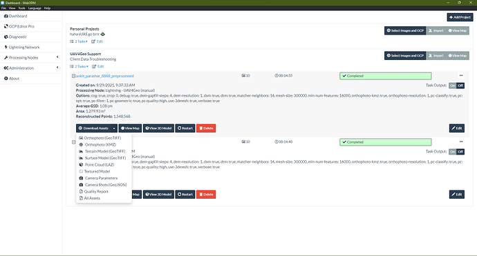

I processed new set of images to check, if file is generated or not. This time also same result as before. I’m here attaching screenshot for your reference.

Is the KMZ there if you download the All Assets (all.zip) file?
No. I downloaded the zip file too. Only .png and .tif files are there in orthophoto folder and no .kmz in any other place.

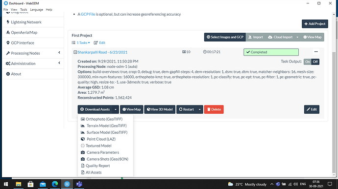

All I did same as you, but still didn’t get the results or .kmz file in assets.
And I’m not working with customized build. I’ve purchased the Windows Native Installer. And using the same on my Windows 10.

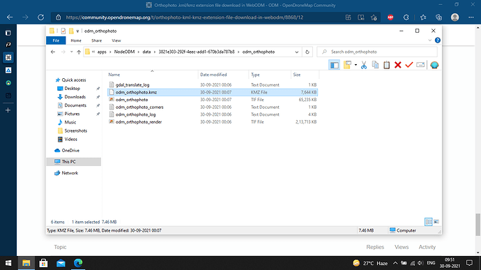

If you go to D:\WebODM\resources\app\apps\NodeODM\data\3821e303-292f-4eec-add1- 670b3da787b8\odm_orthophoto\ are you able to see the KMZ?
The log shows that it should be created correctly.
Very strange indeed.

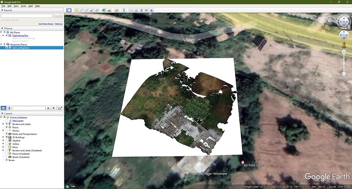

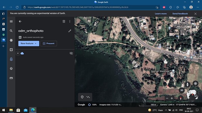

Yes Sir, It’s there.
I even checked it on Google Earth. It doesn’t show any overlap with ortho-photo but it is in exactly correct cordinates.
Yes, strange indeed. There something wrong with UI and backend connection or processing of .kmz file.
Even if it is there, it is not useful yet.
It is working in Google Earth Pro Desktop.
I believe the browser version is still pre-release and experimental.
ohk Got it. But still it doesn’t solve the problem of not getting .kmz file on WebODM UI or web instance.
