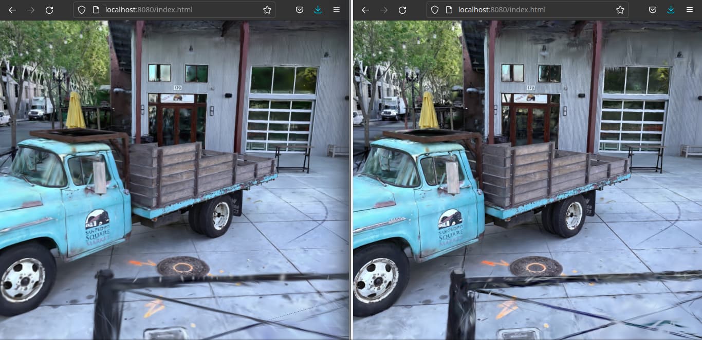

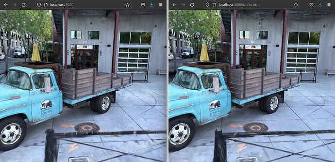

Left = OpenSplat after 30k iters
Right = Splatfacto from nerfstudio v1.0.0 with 30k iters
viewed by mkellogg 3D Gaussian Splat viewer

Cool benchmark!
Some differences might be due to the optimizer scheduler (Implement optimizer scheduler · Issue #6 · pierotofy/OpenSplat · GitHub) not being implemented yet.

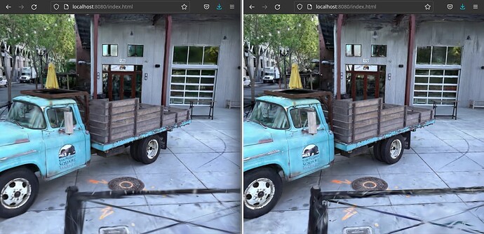

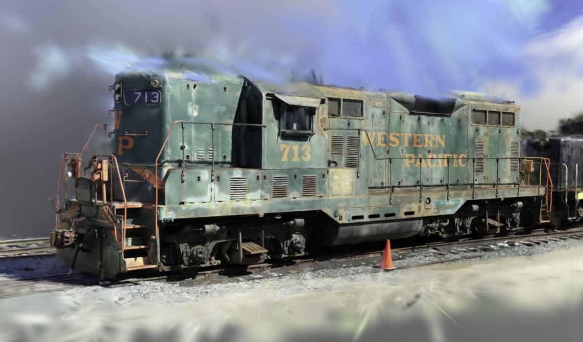

Just finished adding the optimizer scheduler, which should help get the scene to converge toward finer details.
Train scene after 7k iters.

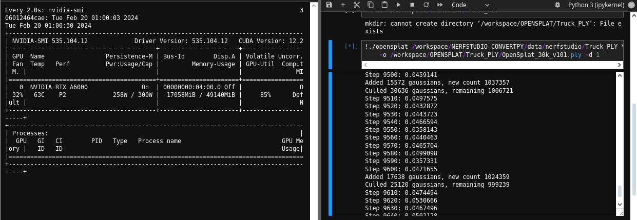

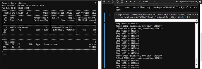

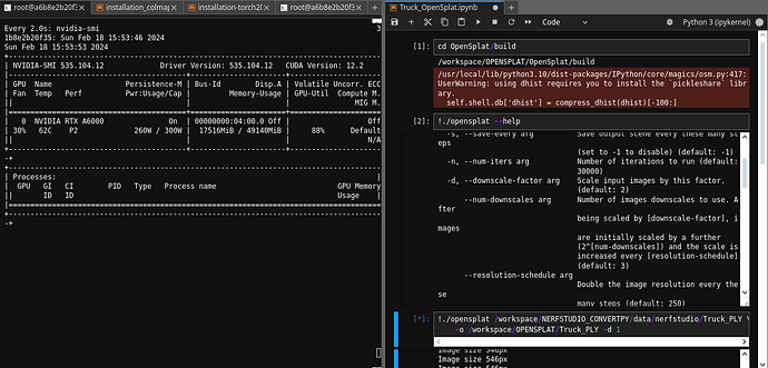

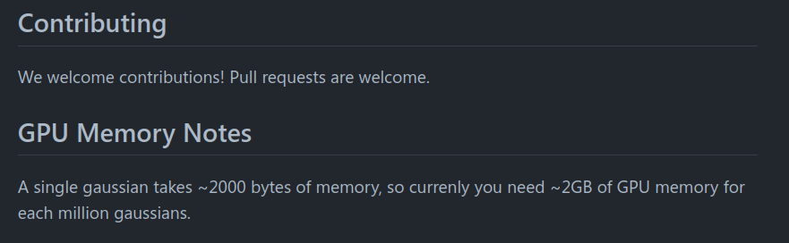

Is something wrong with my installation or my configuration?
Thats being said for each million of gaussians, it consumes 2 GB VRAM. But in my own experiment, it needs 17 GB of VRAM

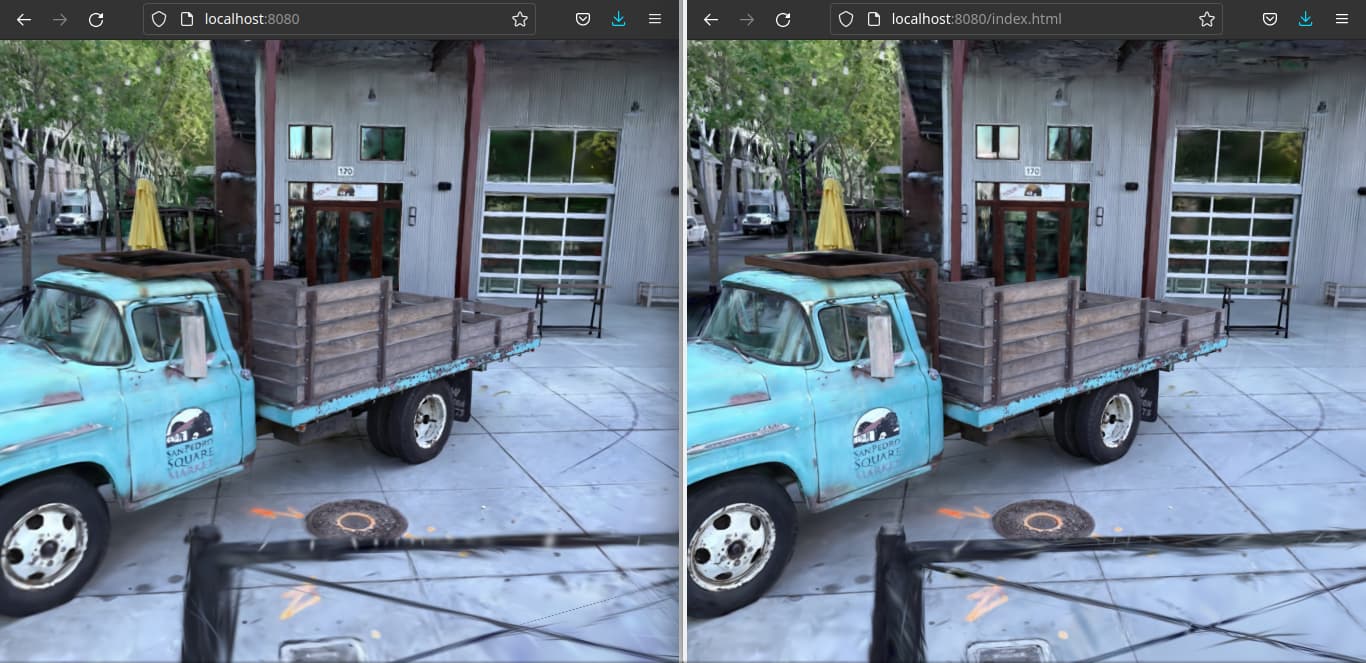

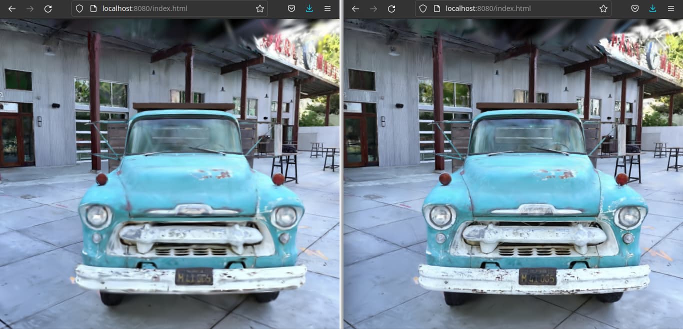

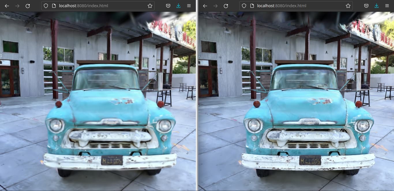

left = OpenSplat 30k --downscale-factor 1 commit: d72815de5e1f04d00509cf5e3128cfa7cebf3b97
right = OpenSplat 30k --downscale-factor 1 commit: 2db50409fa07b762f9c9dd245e1c98a487f1facb
Well done, I see better result in the newest commit (right images)
Memory allocated by libtorch is not automatically released, but it’s kept in an available state. Don’t trust the number from nvidia-smi. The actual usage is much lower.

Something is going on. I try it on Ubuntu 22.04 LTS, and it consumes >10 GB with -d 1 in 251 images with 960 x 540 resolution. I check it from nvidia-smi. -d 1 argument means it run at original resolution instead of downscale resolution.
This thread also tested it with Windows and got OOM too with Banana dataset with 8 GB RAM and -d 2 argument. Mac/Windows Support · Issue #3 · pierotofy/OpenSplat (github.com)
Hopefully it fixed (in Windows) since this PR : General fixes that came up with Windows build by salovision · Pull Request #37 · pierotofy/OpenSplat · GitHub
VERY GOOD NEWS

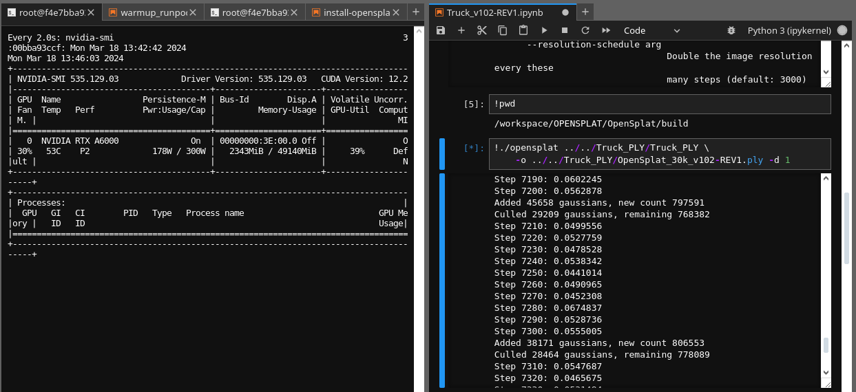

This commit Reduce VRAM consumption by pfxuan · Pull Request #43 · pierotofy/OpenSplat · GitHub and Mac/Windows Support · Issue #3 · pierotofy/OpenSplat · GitHub seems fix VRAM OOM.
BEFORE (USE >16 GB OF VRAM)
AFTER (USE ONLY ~2 GB OF VRAM)
Thanks @pierotofy and ALL contributors
