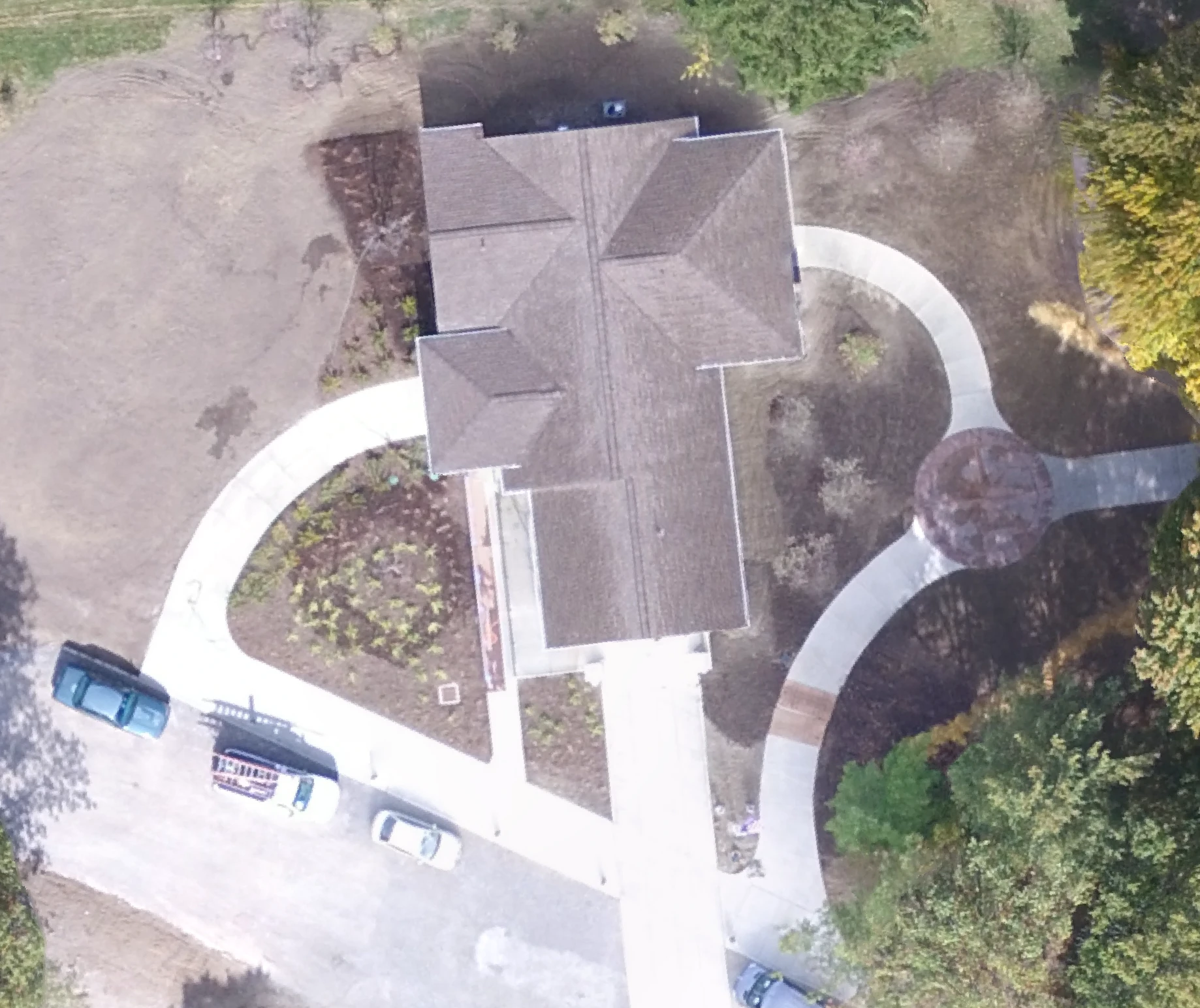

Unsurprisingly, missing MVS-Texturing features specific to orthophotos:
texturing
But a fairly functional 24.04 upgrade is no small feat. Thanks for starting this @NathanMOlson!
