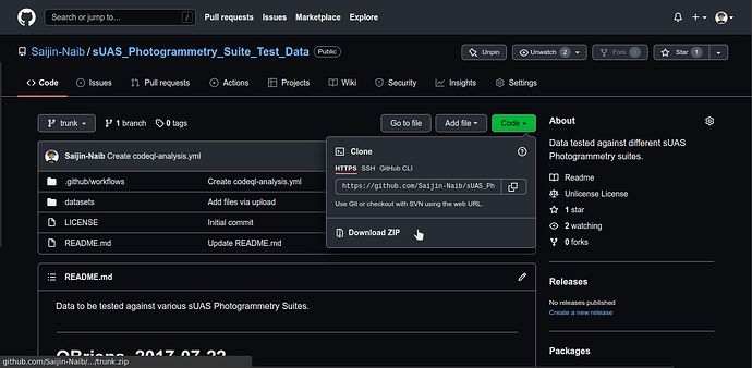

Is there an easy way to download all the files in a dataset on github? Loading each individual image and saving is not really feasible.

Yes! The download as Zip button just above the source code on the right side:
Ahh, it’s in a drop down menu after clicking on ‘Code’ in Chrome.
Thanks! :slight_smile:

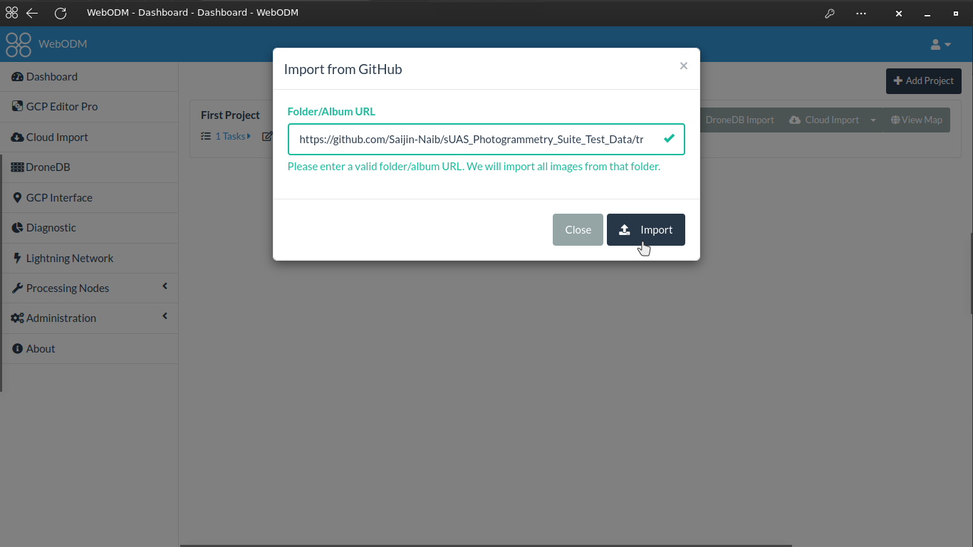

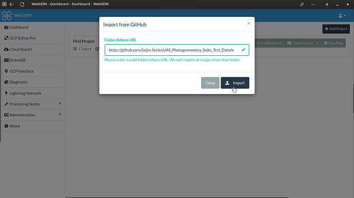

Another neat trick is to import them when using the Cloud Import Plugin. When you go to add images to a task, click it, choose GitHub, and then paste the GitHub link:

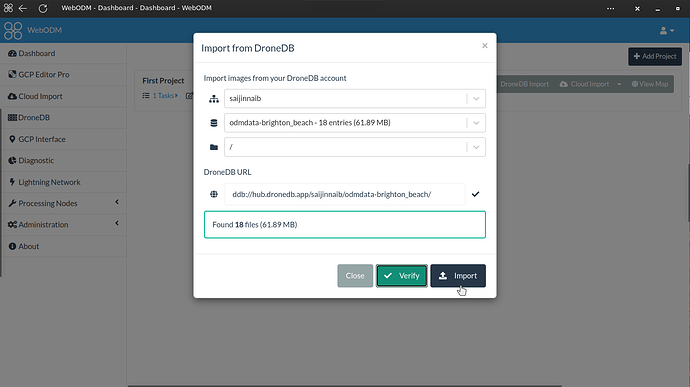

We also have the very new & shiny DroneDB plugin:

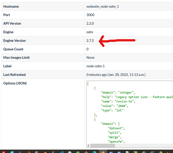

In the by ODM Version there are values for version 2.7.2 but last tag in Repo ODM is 2.7.1
How can this be ? Is this a typo ?
Interesting… those 2.7.2 additions are mine, and I was going by the self-described version number within the processing node info screen. I just updated yesterday via “./webodm.sh update” so maybe the tag has yet to be applied.

Sometimes we will have a testing version deployed that hasn’t been marked stable and released within WebODM for Windows native and/or tagged/compiled on GitHub for general consumption.

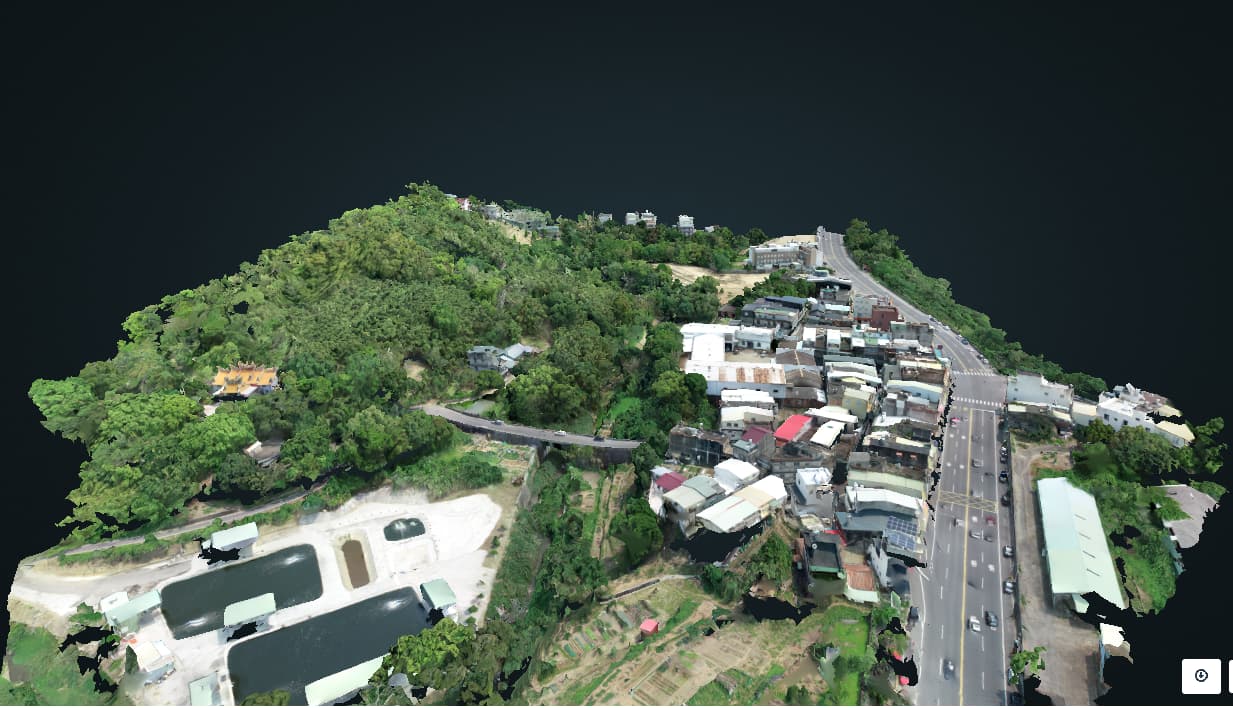

ID Benchmark Number 2
DATASET Dataset Name Tuniu River 1
PROCESSING_TIME Time taken to Process The dataset 5h 57m 43s
PROCESSING_SUCCESS Confirm If process was successful Y
ERROR_TYPE Mention error if any occured
RAM_SIZE Size of RAM allocated 96 GB
RAM_CLOCK_SPEED RAM Frequency of the Machine 2933 MT/s
CPU_TYPE Make and model of the CPU Intel i7 10700K
CPU_CLOCK_SPEED Clock Speed of the CPU 3.8 Ghz
CPU_NUM_CORES Number of Cores of the CPU 8
STORAGE_TYPE Storage Type of the system. NVME SSD
OS Operating System of the Machine Windows 10 Pro
VM_TYPE Virtual Machine on which ODM is running on Native Windows
ODM_VERSION Version of ODM Used to Benchmark 2.7.1
ODM_CLUSTER Delcaration of usage of Cluster ODM N
CONFIG_NAME Mention of the Configuration in which the dataset is being processed 3D
CONFIG_RESIZE mention of image size if images are being resized -
CONFIG_OTHER Other Configurations made that are worth mentioning Options: auto-boundary: true, mesh-octree-depth: 12, mesh-size: 300000, pc-geometric: true, pc-quality: high, use-3dmesh: true
TEST_DATE Date of Test 2022-01-30
TEST_BY Information of the individual who tests the data Gordon Garradd
INCLUDE_IN_SUMMARY Check if Data has been included in summary Y
NOTES Additional Notes GPU feature extraction

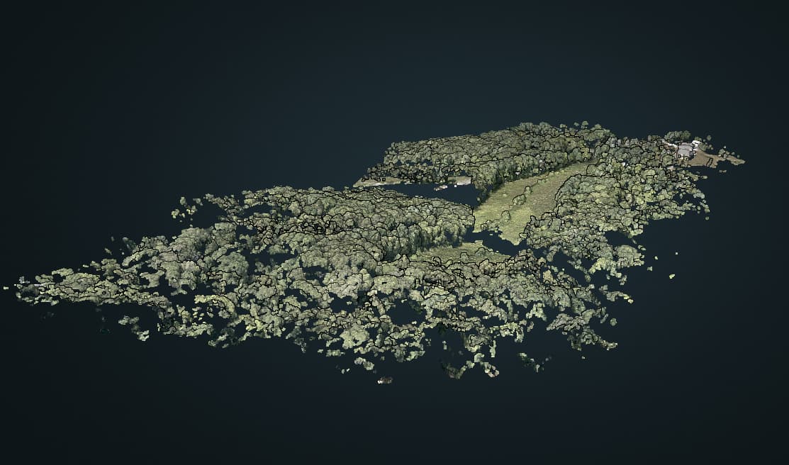

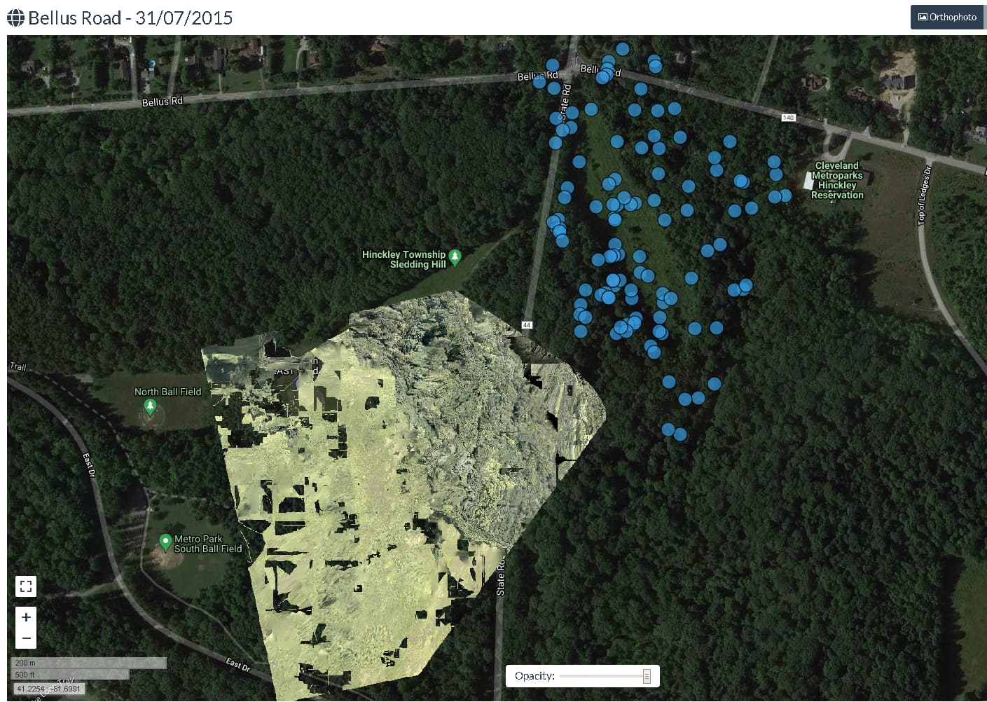

Are you still interested in Benchmark info for tasks that have produced messy results?

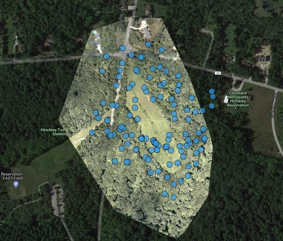

Bellus Rd camera distribution appears to be all over the place, and the PC is broken, half of the ground appears to be at an angle of about 15 degrees to the other part.
1h 03m 14s
Options: dem-resolution: 2.0, dsm: true, orthophoto-resolution: 2.0, pc-quality: high, pc-rectify: true
EDIT, since I cant post more than 3 times in a row.
Build 47 gave an even worse result than build 51 above
56m37s
The 3D model is a complete mess, with nothing recognisable.

Gordon, re: messy datasets. Yes that’s helpful also. That sort of thing may point to issues in the code or the dataset itself. I’m going to try to reproduce on my end and see if I can tell what’s going on.
Gordon, could you post or send me the benchmark data for the run you did on build 51? I get a very similar result on my end, and I think that’s just because the original flight plan coverage wasn’t great. My older benchmarks on Bellus have terrible 2D and 3D outputs too. I think it’s just a difficult dataset. We ought to consider taking it out of the recommended datasets really, but for now the timing data is still useful.

I deleted all the associated files last week to save disk space, so I’ve just run it again, with similar settings. The report, task_output and log.json are here -
https://drive.google.com/drive/folders/1C9BenPJEufyZwd_wyyuTmr3EShuZ0NUF?usp=sharing
